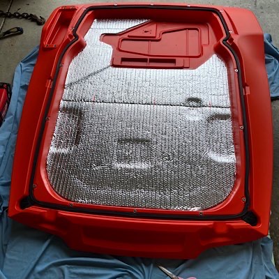

I just used some batt insulation we had left over from a project and a little 3m spray adhesive. The roof will hold it in place.
So you just laid it in there on top of the air ducts and 3m the top of the insulation before you put the top back on?
4,694
1,006
The silver stuff appears to have been attached to the bottom of the roof with the spray adhesive.
The batt insulation was not attached to the roof with any adhesive.
At least that was what I got from the recent posts above

On my two pictures I used the 3m adhesive to keep the batt insulation in place where I laid it. The only thing that was under the roof when I removed it was what looked like a piece of carpet pad right over the drivers seat. Basically nothing for factory insulation. The small silver pieces are Reflectics insulation. I added those in places that did not have the room for batt. I wanted to cover all the AC duct work while I had the roof off.
