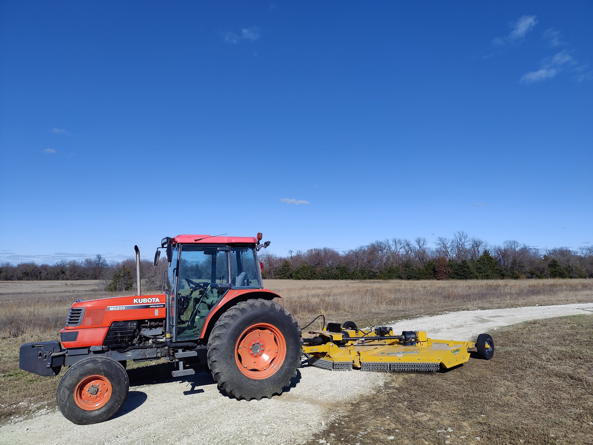

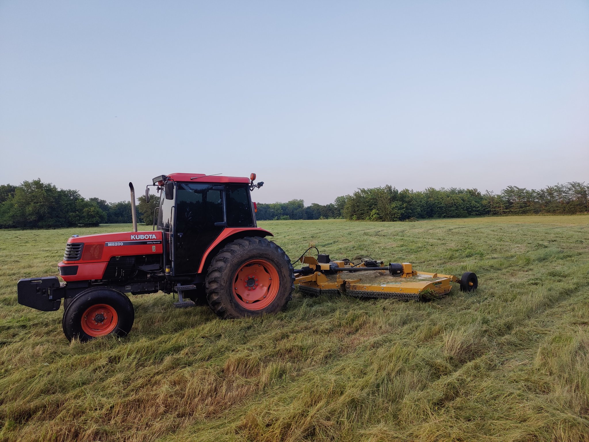

Last August, I had the pleasure of acquiring a Kubota M8200 which I intended to put to work on our 80-acre farm here in Oklahoma. To complement this new addition, I also invested in a 12ft Bushwacker MD144.

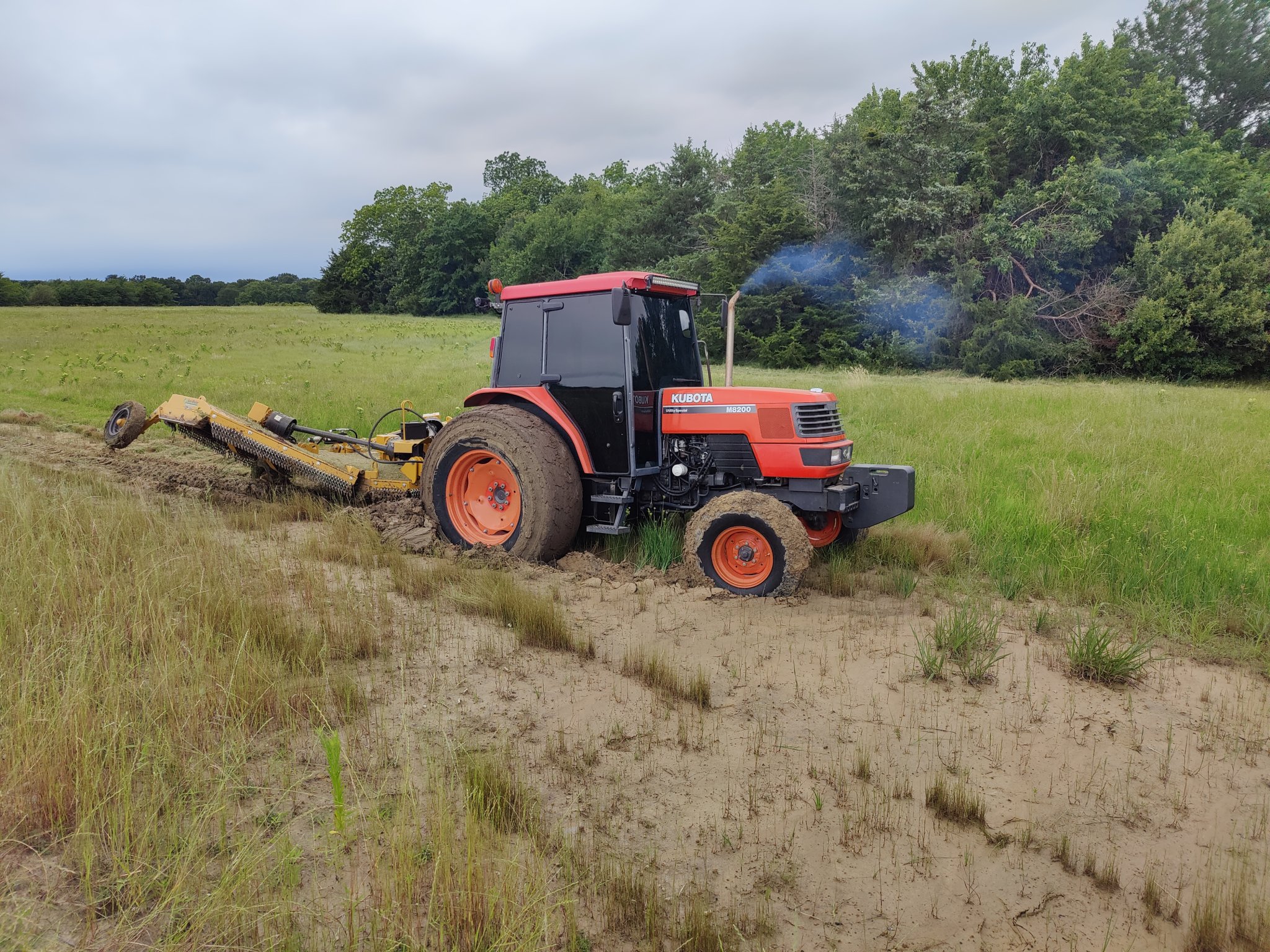

The remainder of last summer was dedicated to a thorough "TLC" maintenance regimen, preparing the tractor for its inaugural fall brush-hogging. The effort paid off handsomely; it took me 10 hours to cut all 80 acres, and the tractor performed flawlessly throughout.

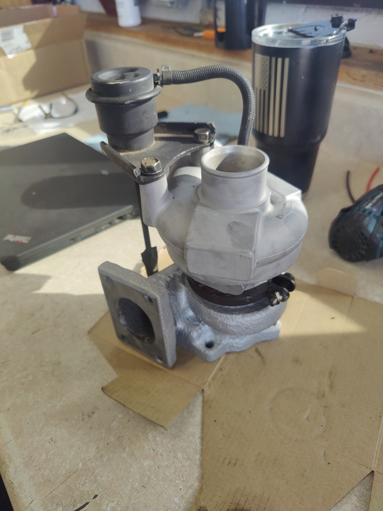

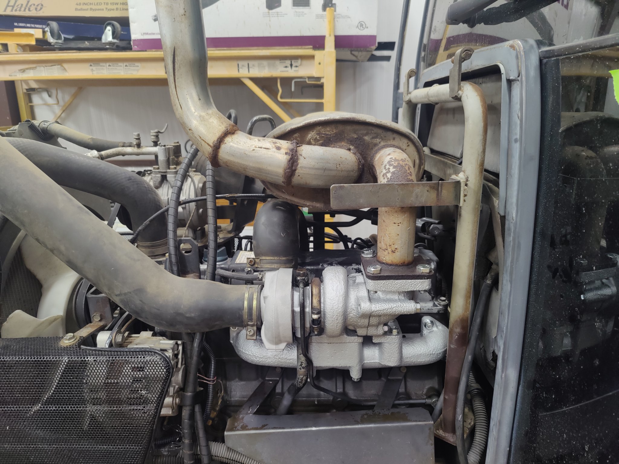

My only persistent concern has been a consistent smoke emission at idle. Given that the tractor starts, idles, and runs otherwise perfectly, my initial suspicion fell on the turbocharger. Upon inspection, the compressor wheel shaft exhibited some vertical play. This discovery prompted the removal of the turbo. I captured a video of the damaged center section, which you can view here: https://youtube.com/shorts/mL9O4TAfNTU?feature=shar.

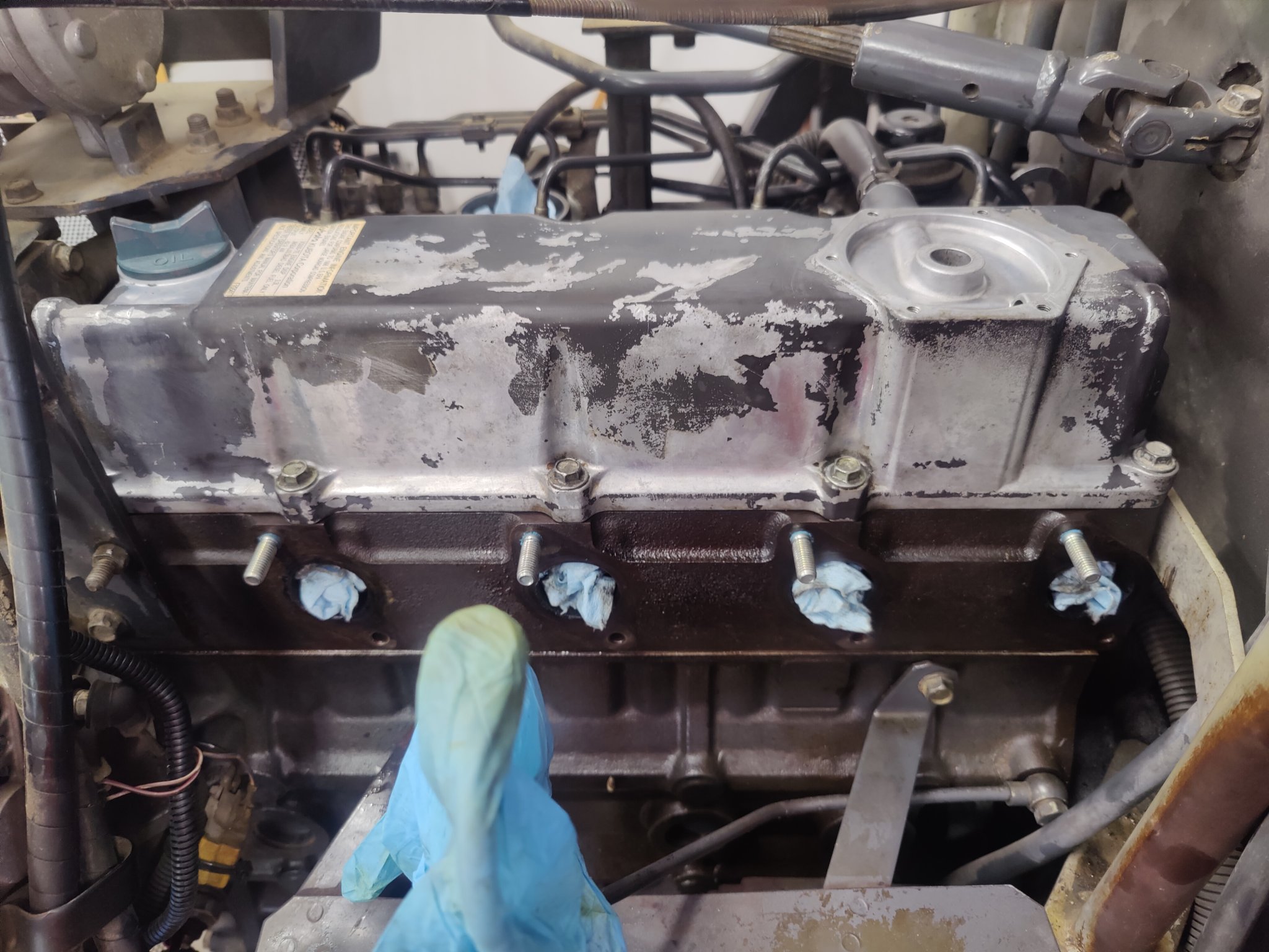

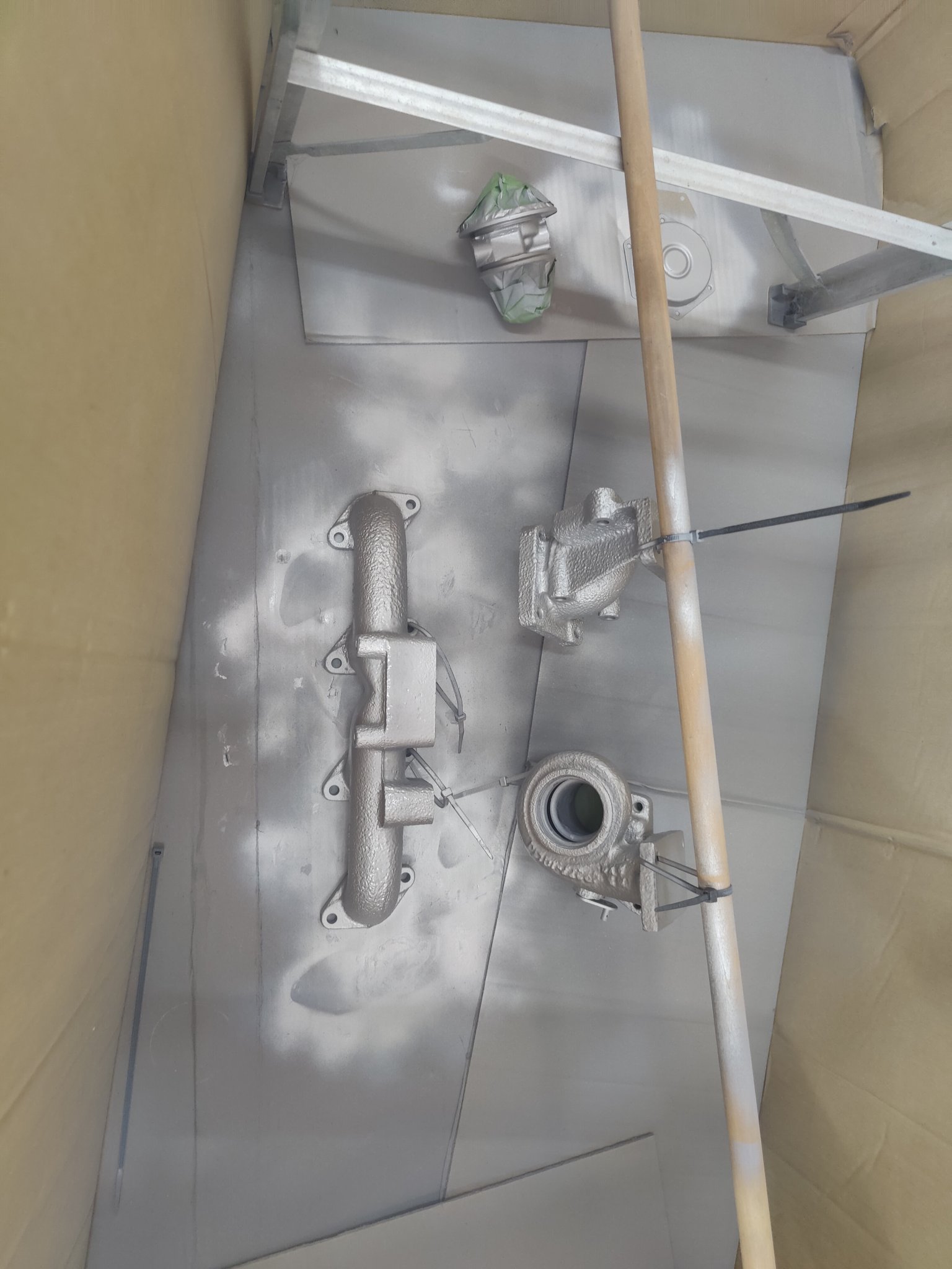

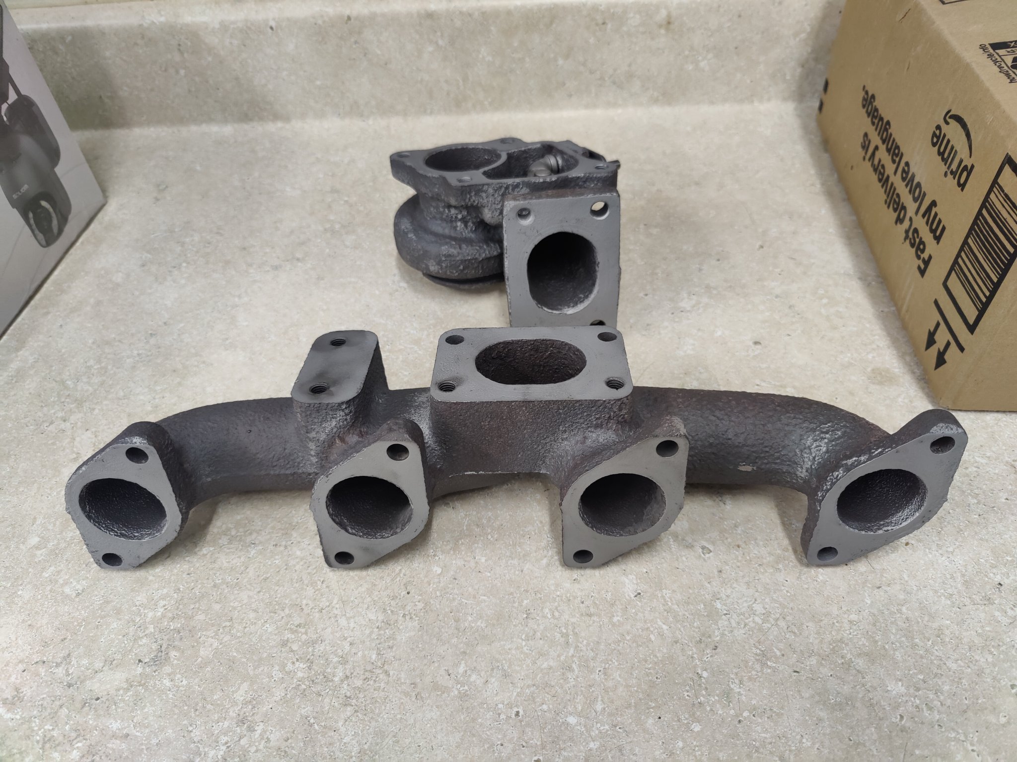

With the turbo off, I took the opportunity to pull the exhaust manifold and replace all the exhaust bolts and studs. To prevent future rust, I media blasted and painted all components.
While awaiting parts, I also tackled the valve adjustment. This is a task I highly recommend to anyone who hasn't checked their valves, especially on a tractor with significant hours. At 2,500 hours, I found most of mine were loose.
I'm pleased to report that everything is now reassembled and back on the tractor. I've spent the past few days running it to cure the new paint, and so far, it's running exceptionally well!

It looks like you are missing the grease zerk from the steering shaft yoke to grease the splines.

80 acres in 10 hours though? How much of that is mowable?
