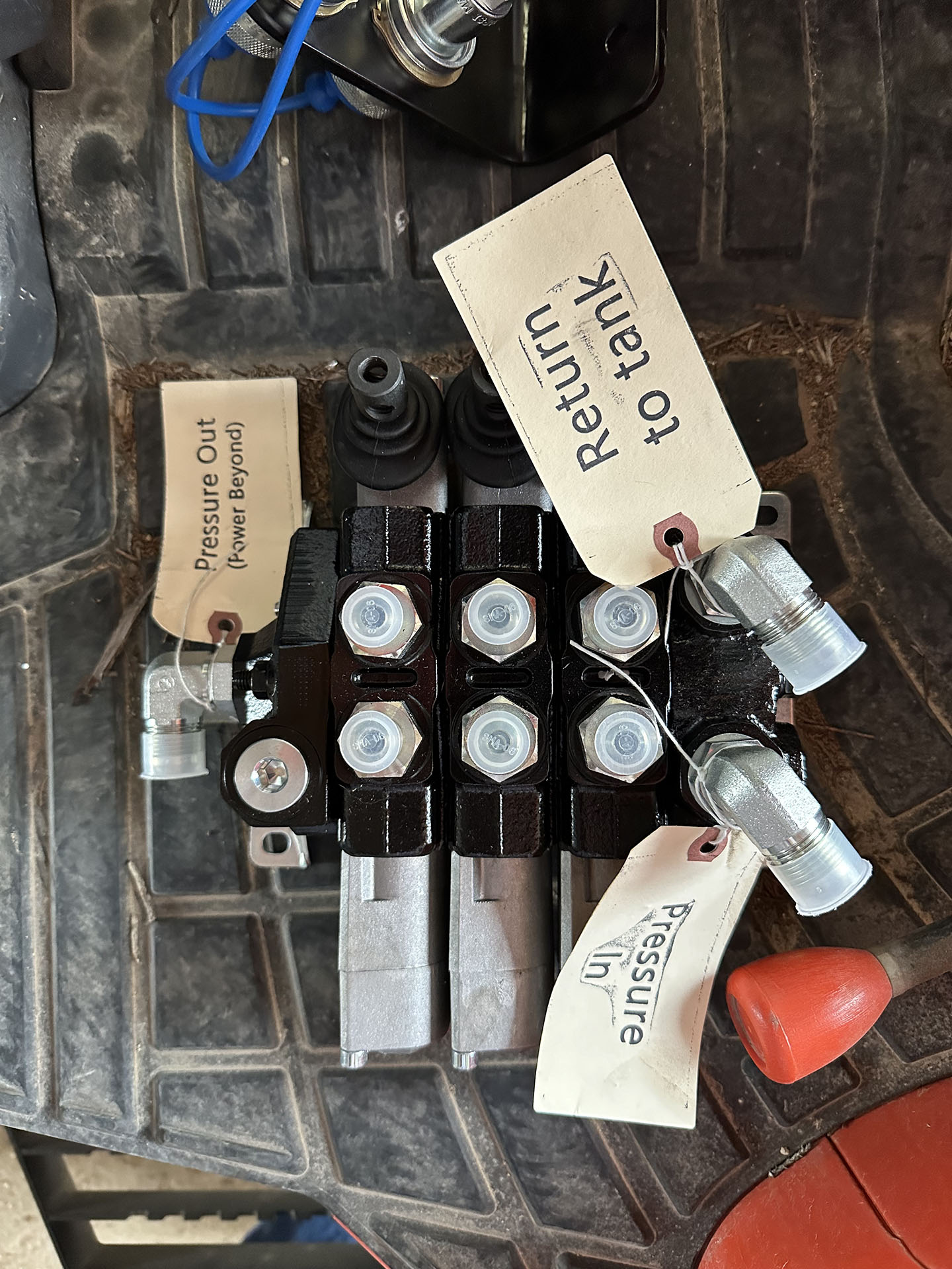

The backhoe supply gets rerouted to pressure IN on the FitRite valve. I think the backhoe on your M62 has two supplies. One is for swing - you want the other.
The pressure OUT on the FitRite valve becomes the new backhoe supply.
Tank on the FitRite valve goes to any tank connection. I dont know the details of the plumbing on your tractor but should not be hard to find a place. You can tee into any existing return line

Based on this information, here is one way that you can plumb.
Exit side of the 3rd function valve to the pressure in port of the rear remote valve set.
Power beyond port of the rear remote valve set back to the disconnected point of the 3rd function on the tractor side.
Return to tank teed into any return to tank line-port.
I'm not saying that this is the optimum way to plumb these, but it can be plumbed like this and everything would work fine.

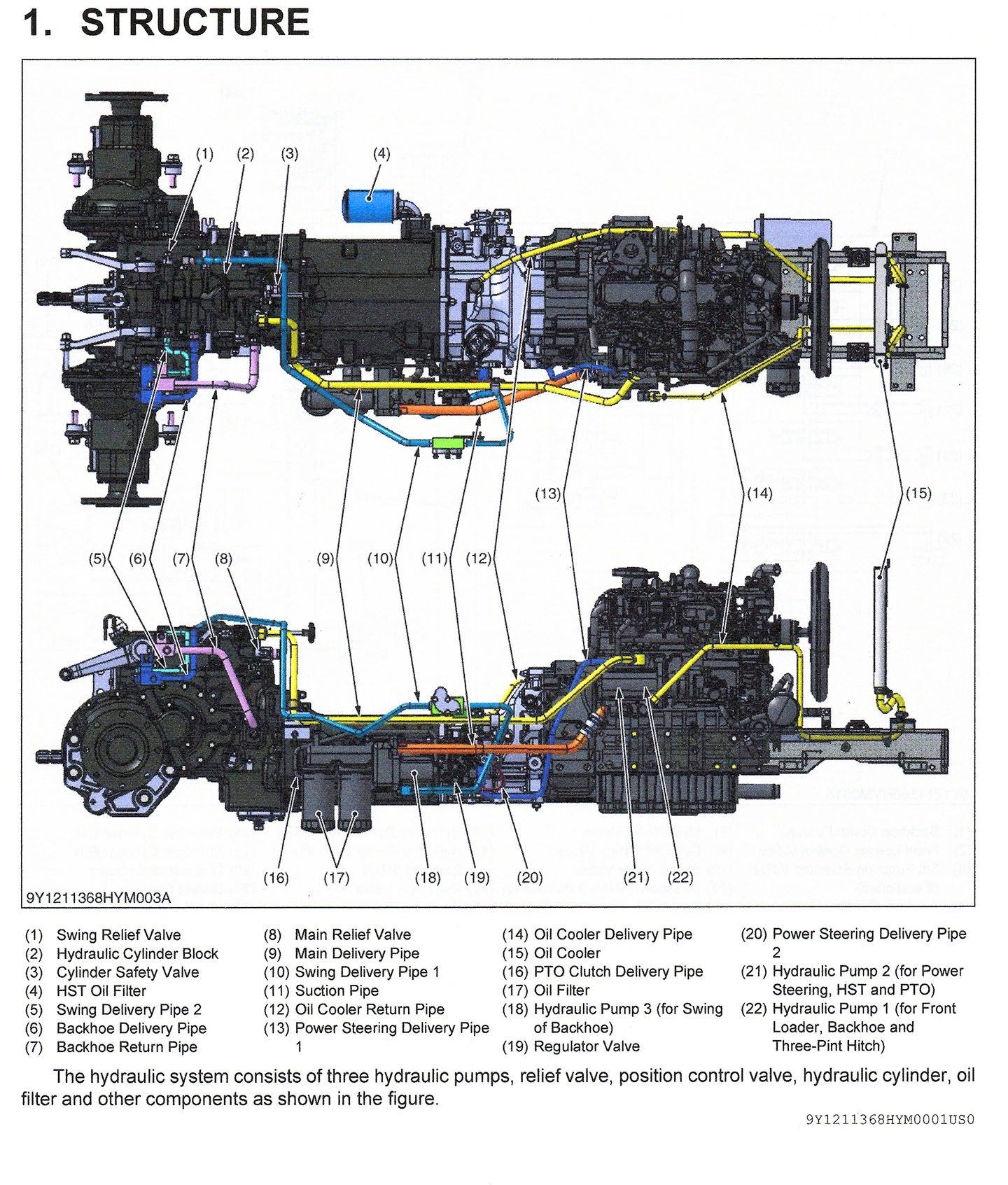

Dan, I'm attaching image from the WSM. You may already have it, but it does sort things out some. View attachment 122968
Here is the plumbing for the loader valve. I imagine the factory 3rd function is inserted in the PB line right after the loader valve. Should be obvious when you look at this area.
So IN on your your FitRite valve could go in right after the third function and the tank return could tee into the loader tank return.

I use the backhoe swing pump connections for my rear remotes. No permanent piping changes needed. Just use the swing pump quick coupler and the backhoe drain line quick coupler. I don't need the remotes when the backhoe is on.

Thats one way to do it but as stated the remotes will not be available when the backhoe is mounted.
If you plumb the remotes off the 3rd function/loader valve they will be available at all times and would be using the implement pump. That is easy and pretty obvious. It can go ahead of or after the 3rd function.
We may be able to figure out how to run it full time off the swing pump but not without looking at the physical plumbing to see where it might by tied in. The parts diagrams dont provide a clear enough picture of that.

There is no need to plumb anythimg that would ever cause trouble operating any valve at any time.
if you go the way of that swing hookup you found you will not need or want a power beyond line on the remotes. They will never be connected to a downstream load.
it may be possible to utilize tje swing pump using a full time power beyond line but that depends on finding a spot to tap in.
