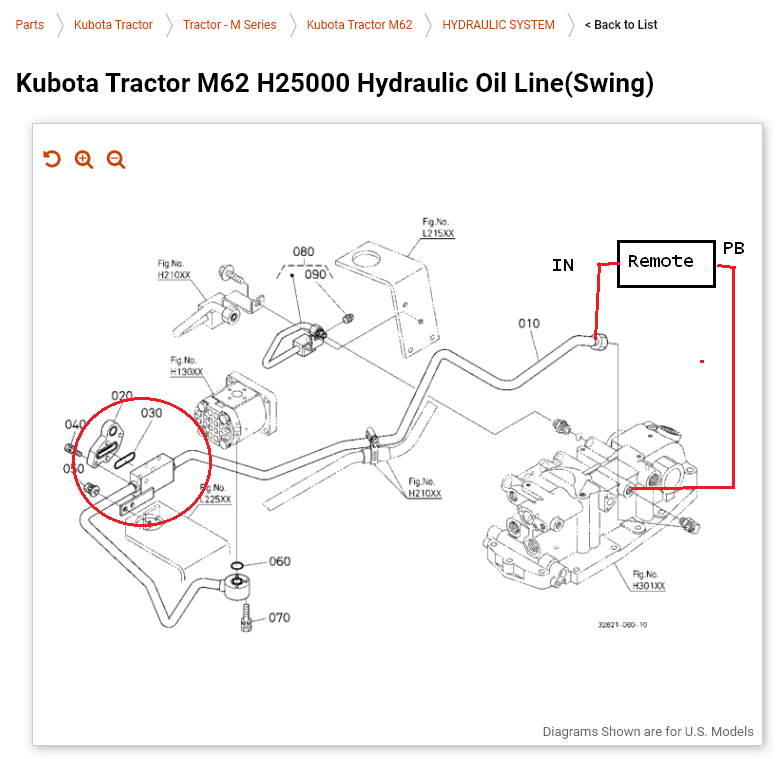

Here is a third option that I kind of like. It uses the swing pump for the remotes. I have sketched in one possible connection to that circuit that would require nothing but a couple hoses.
But it looks like Kubota has provided a hydraulic outlet block (circled) in the middle of the swing pump hydraulic pipe. What its used for is currently a mystery to me but if you can find the part number for the diverter block that replaces cover #20 you might have a more OEM connection. I would not be surprised to learn that outlet is used for the OEM remotes....
After some sleuthing I think this outlet block would adapt the swing pump line for your remotes and provide all three of the connections - Pump, out Power Beyond return, and Tank Return.
7J266-68113 - $37 from Messicks and they have 7 in stock
Looks like Kubota used that port layout on over two dozen models, mainly as a takeoff for loaders. I found it by looking up the part number for the factory cap on the M62 then matching that to other models that used the same cap, and from there to the various loader parts diagrams.
So now we need to talk about your FitRite valve. Thats a Bucher sectional - do you know which model? If its the 12 GPM model (HDS11) it cannot handle the 16 GPM implement circuit flow.
Looks like Kubota used that port layout on over two dozen models, mainly as a takeoff for loaders. I found it by looking up the part number for the factory cap on the M62 then matching that to other models and from there the loader parts diagrams.

At 17 GPM you can use either pump.
Let me correct my comment about the outlet block on the swing cylinder pipe. That is a single pipe so the tank return port is going to be blocked off. You would just have pump out and power beyond return.
