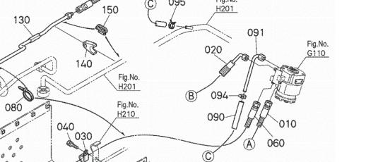

Probably not it but........You've cleaned the screen as well? Top left. 030 out of picture

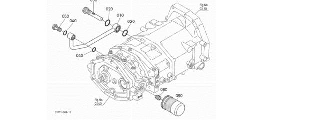

The charge pump gets its supply from the power steering exhaust side return line. If raising the charge relief setting raises the pressure, the inlet screen (030) is not likely restricting flow. Right next to the charge relief valve there's a second relief valve to protect the filter - try raising that one too. If either relief valve is weak/leaking the charge pressure would drop. (see .pdf) Good luck, Dick B

Do you still not think 030 screen is restricted?

My thought was that if the pump's oil supply was being restricted, shimming the relief valve wouldn't have helped. But we're running out of things to check from the outside. Wouldn't hurt to take off the pipe and see what's in it.
By adjusting the relief valve, it raised the line pressure. Logic says, therefore some fluid must have been passing the relief, and now less is passing. So is the relief still passing when it shouldn't be? Is there a bit of crap stuck in the relief valve holding it open? May be worth removing the valve for inspection?
Is the filter screen, number 16 on your flow diagram?

100 td - scroll down on the flow diagram for the parts key - 16 is the filter
So where is the FILTER-Screen FILTER 54516-36560 if 16 is the Hydraulic Filter FILTER,OIL TA240-59900, in the flow circuit?
They both appear on the parts page in post #2 (your post) - a full copy including part numbers is attached below.

Yes they appear on the parts diagram as I originally posted, but the question I asked is where is the screen in the flow diagram?
The circuit you posted doesn't appear to show a screen in the circuit. Whilst it may not be the cause of the OP's problem, some other tranny circuits have a screen in series with the charge pump inlet. I can only assume the screen would create problems if it was restricted (and it may not be), but if I was investigating any HST problems the first thing I would establish is that all filters and screens are clean or new. Hopefully the OP finds fault with the clutch instead.
The circuit you posted doesn't appear to show a screen in the circuit......
Kubota publishes that same flow diagram in many of its workshop manuals and the screen is not shown in any of them. They may not consider it functionally significant. The pipe carries the exhaust side oil returning to the transmission from the power steering circuit. A portion of the flow is diverted to the charge pump's suction.
Attached is Kubota's HST Troubleshooting page from the L48 workshop manual. Except for the clutch and relief valves most functional problems lead to their recommendation to replace the hydrostatic transmission assembly.

Kubota must be getting very lazy to not show them, mine is shown in my old manual. As previously stated, whilst it may not be the problem, it's there for a reason. To not clean it and rely on the trouble shooting flow chart alone to replace the transmission would be crazy, but I guess that's what happens eh?
I don't know what that strainer is doing, but I'll have a guess, from the parts diagram, it appears that it's installed in the base of the mid case or mid case spacer, and supplies oil to the HST. As the charge pump is inside the HST, I can't see how exhaust flow from the steering goes directly to the charge pump. If it did, and you had a failure in the steering circuit, you would also ruin your charge pump.
Therefore I assume the strainer and pipe supply oil to the charge pump.
Once again it's probably not the fault, but surely it's worth checking, and I can't understand why it's not a part of the diagnostic.
From the following diagrams, to me as least, it appears that the steering exhaust actually tees into the suction line and plays no part in the charge circuit.
