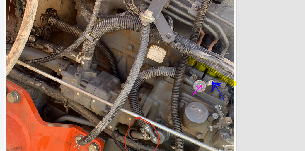

To know you were getting good fuel to the injectors you would crack these lines (yellow) at the injector end for each injector, but don't do that yet.
Try this:
With the tractor running, Take the vent line off at the blue mark, then open the jet start valve (purple) and see if you get good flow.
Try this:

It's hard to say what the exact cause of the issue is.
If it lack of flow, it's either lift pump or a blockage in the line, filter or tank.
If it's good flow, could be pump or injectors, other tests will need to be performed.

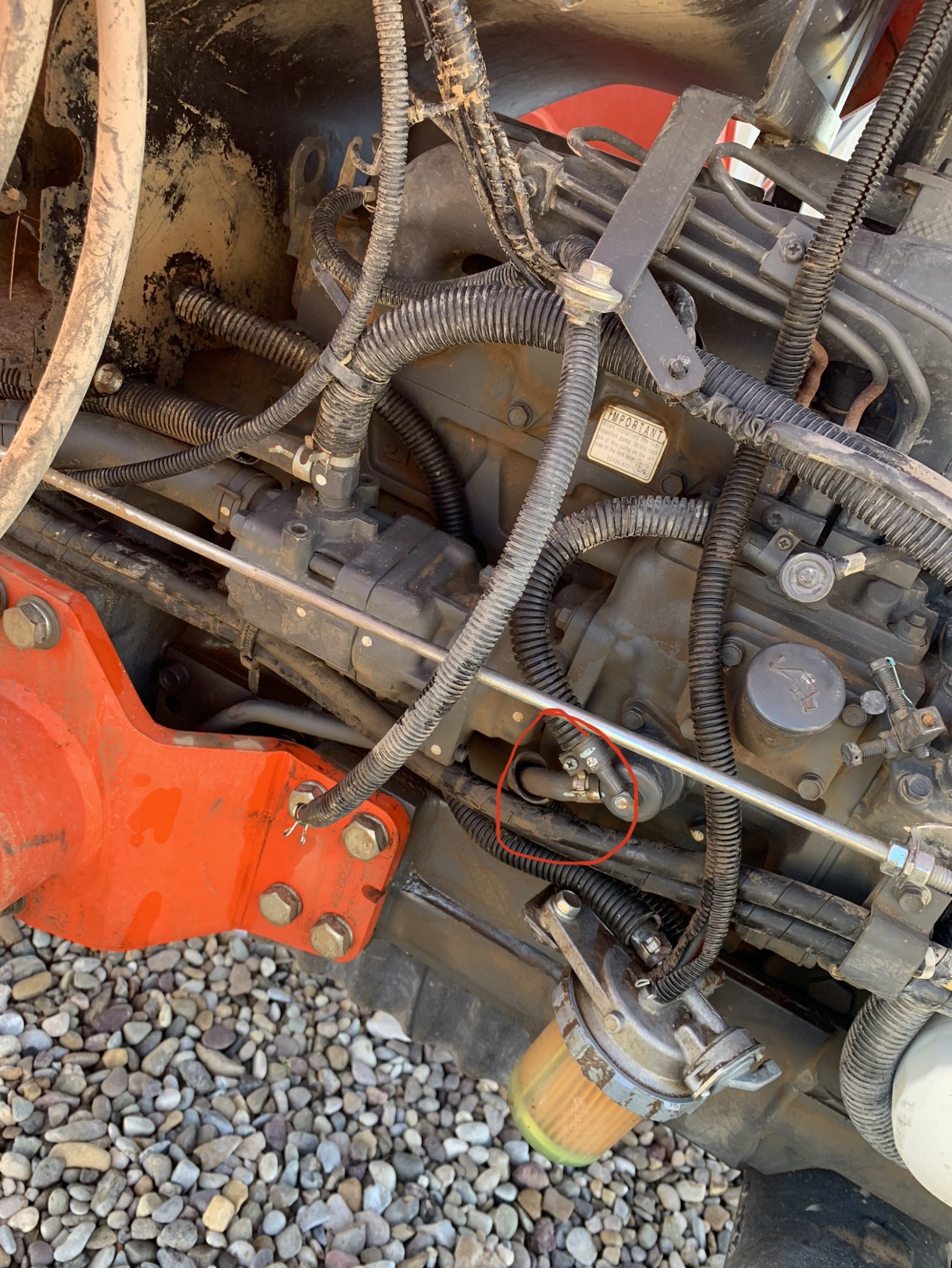

Update: i put seafoam in the tank & I tried what you suggested and ran the tractor with the vent line off and opened the jet start valve. Should it be a full constant stream? Or spitting fuel?
regardless after doing this the tractor now runs fine? Ran it for 2 hours without any problems.
