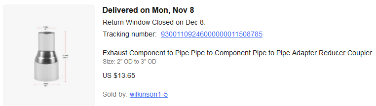

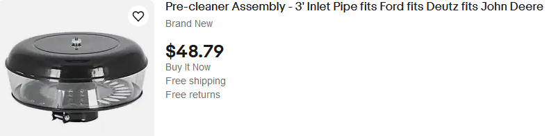

Nice work! What's that thing sticking out of the hood? My hood has a blanked off hole there. I've wondered what it's there for.

He put an aftermarket dust separator / pre-air cleaner on it.
34,193
9,384
It was for a pre cleaner but I can't find any reference to an option number for it.
I could see it being useful if you were working really dusty material.

The blanked hole on the top of the bonnet doesn't seem to have a reference anywhere in Kubota docs.
I assumed it was for a pre-filter, so that's what I installed. I used a stainless exhaust pipe adapter to get from the OEM input hose to the pre-filter. You can see it sticking out of the bonnet.

These are the parts to install a pre-filter from ebay. Just turn the OEM hose around and line it up with the hole in the bonnet. I used radiator-type clamps to secure it all.
