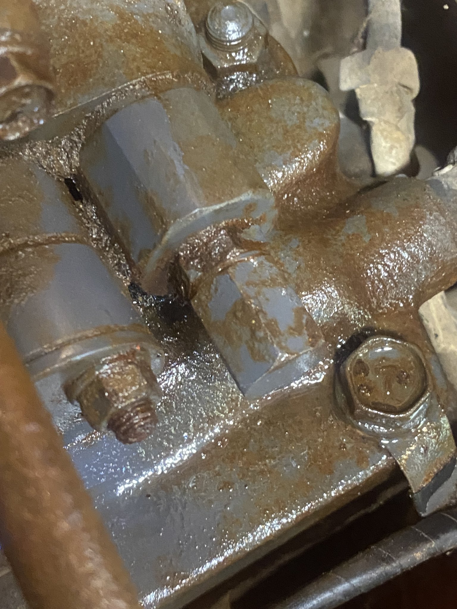

Kubota L35 big mistake on hydraulic loader valve looking for advice.

The aftermarket valve does not have float
If your tank return line was aldo disconnected the HUSCO relief vslve was deadheaded
Is the used HUSCO a whole valve for $750 or just one section?
Upon further review looks like the relief valve didn’t work because there isn’t one looks like just a plug was installed nice. 750 for the whole thing off another tractor.

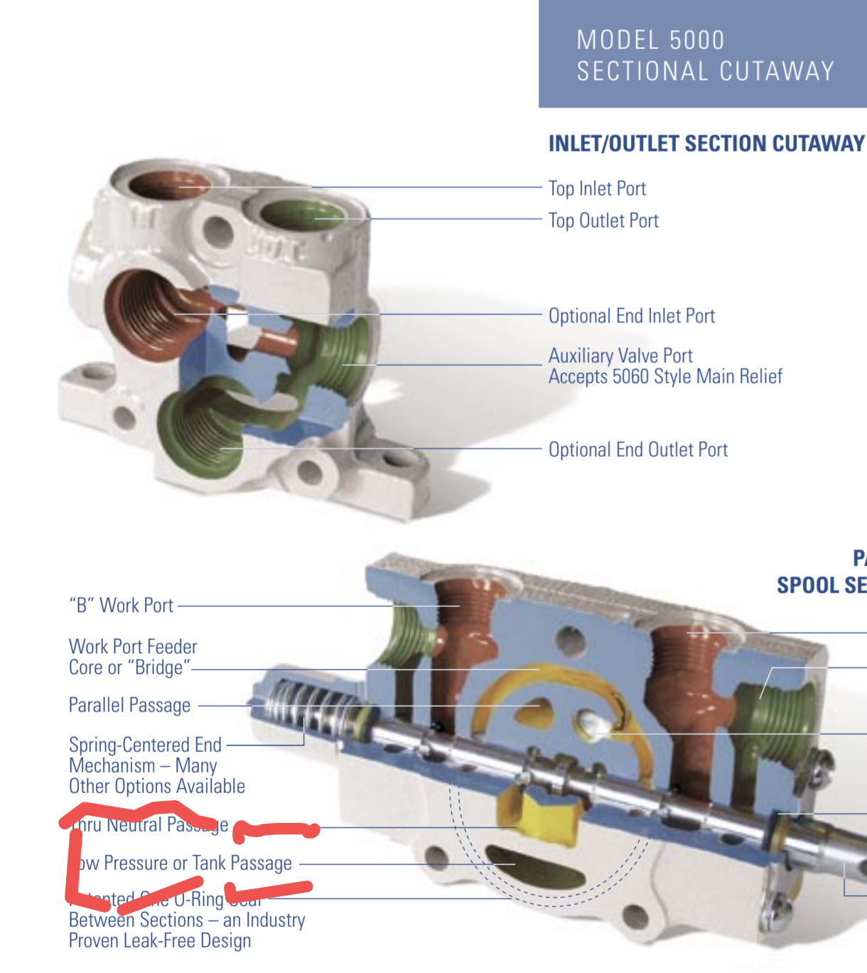

OK, it looks like the tank passage (low pressure) is the one that blew out. @Fluke216, make sure the tank hose is connected correctly and not plugged. @TheOldHokie, do you see any other way this might be over pressured?

I assumex the blocked neutral just blew every thing on the bottom out. But if the bucket spool is shifted to "slow extend" the blocked tank core will see roghly 1.5 times inlet pressure so jaybe tgats what happened. What is tractor side relief set to and whats the rated max on the valve?
