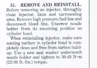

Should I check the resistance in the glow plugs before I take them out with the power wire off? What should I torque the injectors at? I don't have a manual Should I put anti-sieze on the thread? Thanks
34,361
9,595
Yes take the buss wires off and check resistance of each one.
NO anti seize, just the sealing washer.
