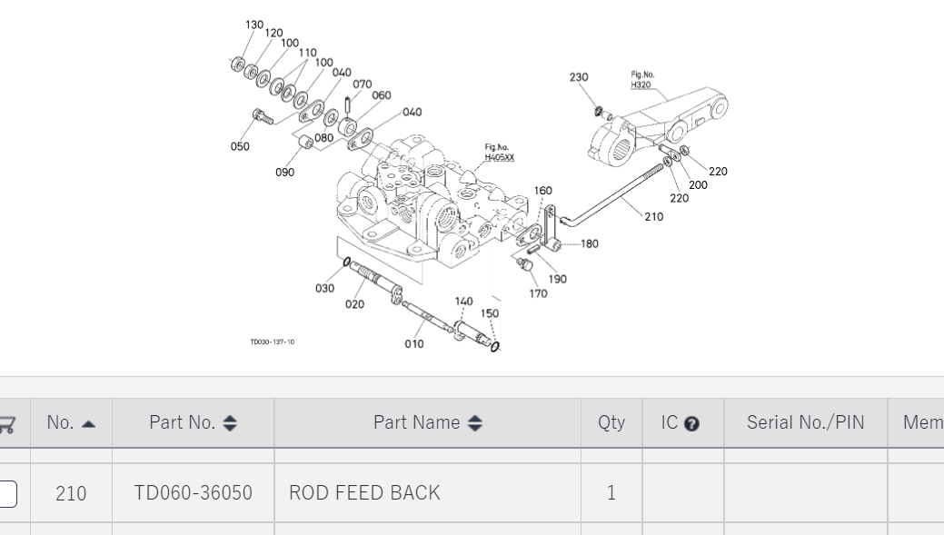

I would also look at the feed back rod/lever. Might be out of adjustment, causing the hunt/bounce. Allows the tractor to "know" orientation of the rock shaft.
Look at Hydraulics section of the Illustrated Parts Diagram here.
Kubota Tractor Corporation - Illustrated Parts List (kubotausa.com)
Should be able to finds tips for the Feed Back Lever's adjustment in the Workshop Manual, that can be found here.
Kubotabooks.com

Sorry - - Not smart enough to attach diagrams well.....
Kubotabooks.com
I messed with that the other day. It either got worse or stayed the same unfortunately.
8,383
4,030
Okay - - did you have the WSM for pointers? The one I linked is free....
Not disputing the opinions of Dan or PoTreeBoy at all. Both very smart guys.
Just when I see/hear of 3PH getting funky, oftentimes Feed Back Rod can be culprit, as it can interfere with continuous operation through the limits of travel.
Do you hear it go to bypass when it bounces? Do you hear sounds at the valve the other guys were speaking of?
