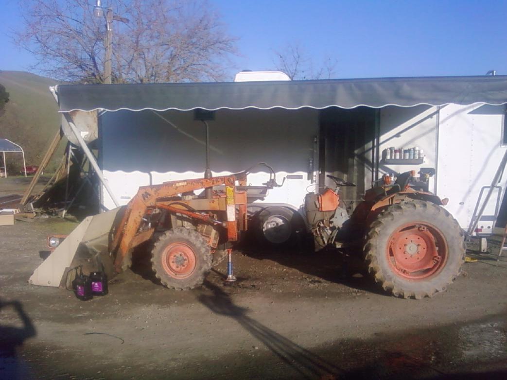

Is a L275 close enough? I found this old pic that shows the setup doesn't have to be very fancy. Just go for it - you'll be fine.
Block up one half and roll the other away - can use a floor jack rolling on some 3/4" plywood. As you adjust the supports before splitting you'll know when its lined up well enough to slide apart easily (and back together).
A flat floor or driveway works better than plywood. Have fun - work safe - you can spend the savings on wild women and alcohol - or just waste it.
