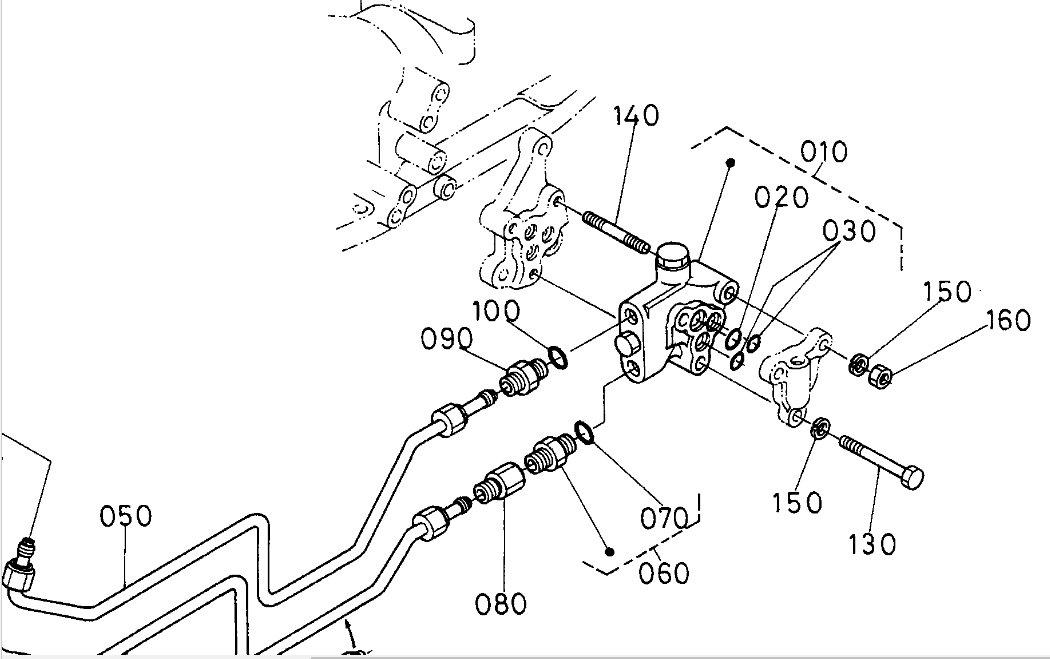

I was looking into adding a loader to my old Kabota. It appears to not have a front hydraulic block, just pressure to the PTO and return to the TANK. An OUTPUT from the PTO to what looks like a relief valve then to the Power Steering and a return.
Is there a place/method to tap into the lines or an adapter/block addition that would allow a connection??

Maybe this diagram from the LB400 parts list will help. Basically, you loop into the line running from the pump to the 3PH valve, using that part 050. The loader valve must have a relief and tank line since you're tying in before the existing relief.

That diagram lead me down that same rabbit hole a few weeks ago with another poster and a L3xx or L2xx tractor & loader.
On those tractors they actually made an outlet block that was sandwiched under to cover of the the PS priority flow divider. That puts it after the relief and the PS takeoff. Probably hard to find but relatively easy to make. The L2750 looks (almost??) identical.

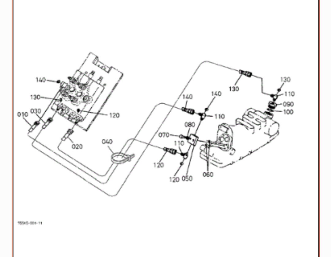

OP, maybe reading through this thread will help.

yES, THIS LOOKS LIKE MY l2350.

Yes, this is how my L2350 is laid-out. I did find some info up here about the block, it's part number is L1792. I have searched the Internet and cannot find ANY information about the part or anyone that has one.

That's the one. Pictures of that outlet block should be helpful.

It's a simple manifold and easily made from a chunk of aluminum.
