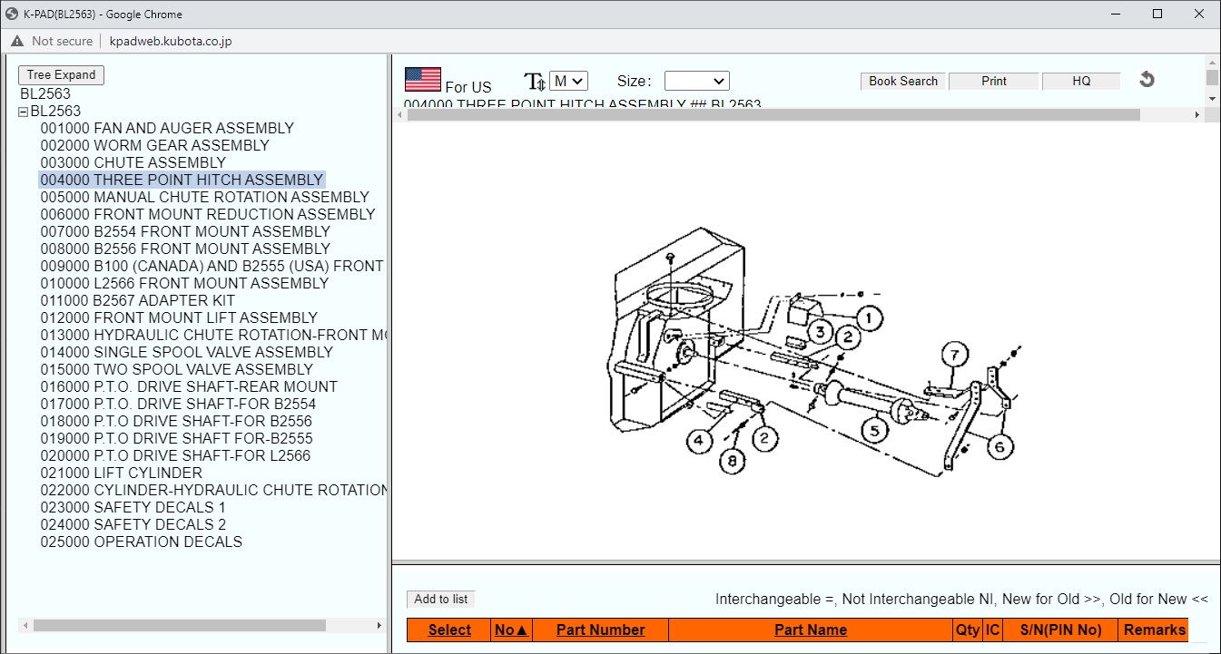

do you think it would be possible to use it as a rear mount unit ? i plan on keeping the loader on year round
I have attached a pict from the Kubota parts web site showing the 3 point hitch parts. The sprockets and chain gear reduction gets removed and a PTO shaft gets attached to the end of the impeller shaft.
When mounted to the front, the snow blower gets lifted by a small double acting hydraulic cylinder. 3point mount.jpg

ive been trying to find diagrams for the front mount so i can figure how to hook it up may i ask where you find your diagrams
Click on the Kubota parts link -- Kubota Parts
Then click "View Illustrated Parts"
Then check the OK box and click open
This brings up search-- put in the model number, then click search-
click open under the "Book" column
Click the "+" sign under expand
You will have a series of parts groups to view

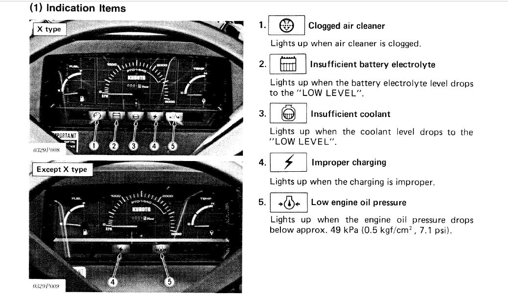

im a new member here. i just bought a l2250 with loader and front mount snow blower does anyone have a downloadable version of the owners manual and service manual. there was a warning light on and it appears to be coolant level but the rad was full
