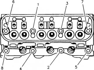

I have a Kubota L1801DT that belonged to my grandpa and I am getting it running as a kind of memorial to him and I need to know the torque specs and sequence on the head bolts.
