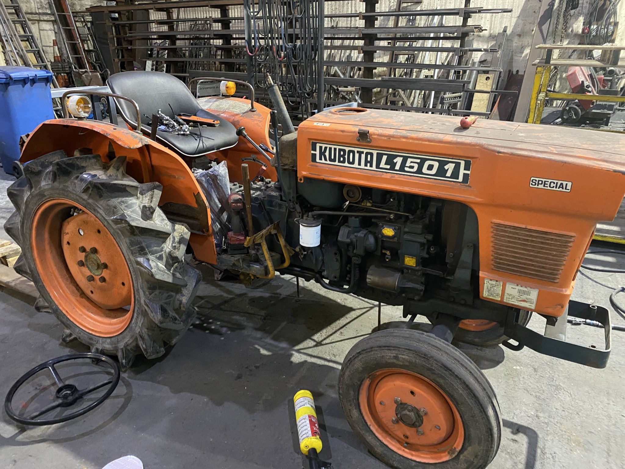

Not sure where you guys would get parts there across the pond. This is not a model that is common in the US - the US model that shares a lot with this is the L175.
On the oil choice I would imagine any diesel oil of 10w30 would work well in that machine.
This is an ebay site via Canada that shows filters .............
https://www.ebay.com/itm/New-Filter...158215?hash=item59243e6507:g:0e0AAOSwDQtcl5Mh
Thanks for the reply
John’s Ranch on YouTube said 15w 40 oil. wold any them do?
I don’t mind importing parts if there at a decent price :)
I’ve got S0 7059 oil filter will that be good to use?
10,964
2,809
Question about your climate .......... if you are in a climate that hit 90's or 32C ....... and does not get cold, as in 32 F or 0 C I would say that 15w-40 is fine - if you get colder than that - I would go with a less viscous oil, as in 10w-30 or 10w-40.
Oil filters can be anything you trust brand wise - for hydraulics - you may want to stick with a OEM Kubota filter. Seems that non OEM brand can have a few problems.
