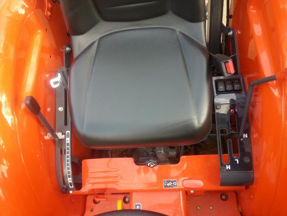

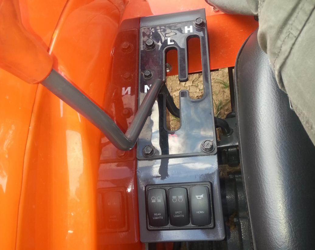

Here is what I came up with. I used custom Carling switches for horn, rear lights, & spotlights. They fit well and are easy to reach behind the shifter. And best of all I don't have to cut up the body of my new tractor.

This looks great. What did you use as the switch plate?

I bought the Carling snap in switch trim with the switches and made an extension of the factory shifter bracket out of some scrap plate I had in the barn. I painted it Kubota gray and used the two factory bolts to mount it. Took longer for the paint to cure than it did to make the plate.
It's a much more convenient location in my opinion and they are protected.

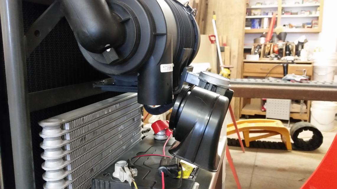

Well, I *finally* got around to installing the Kubota horn button and a Stebel air horn I've had for a long time. Figured I'd post pics and tie this thread off, sorry for the delay (I hate threads that just stop open ended)
I installed the horn over the battery, just behind the grille. Yep, it's LOUD.

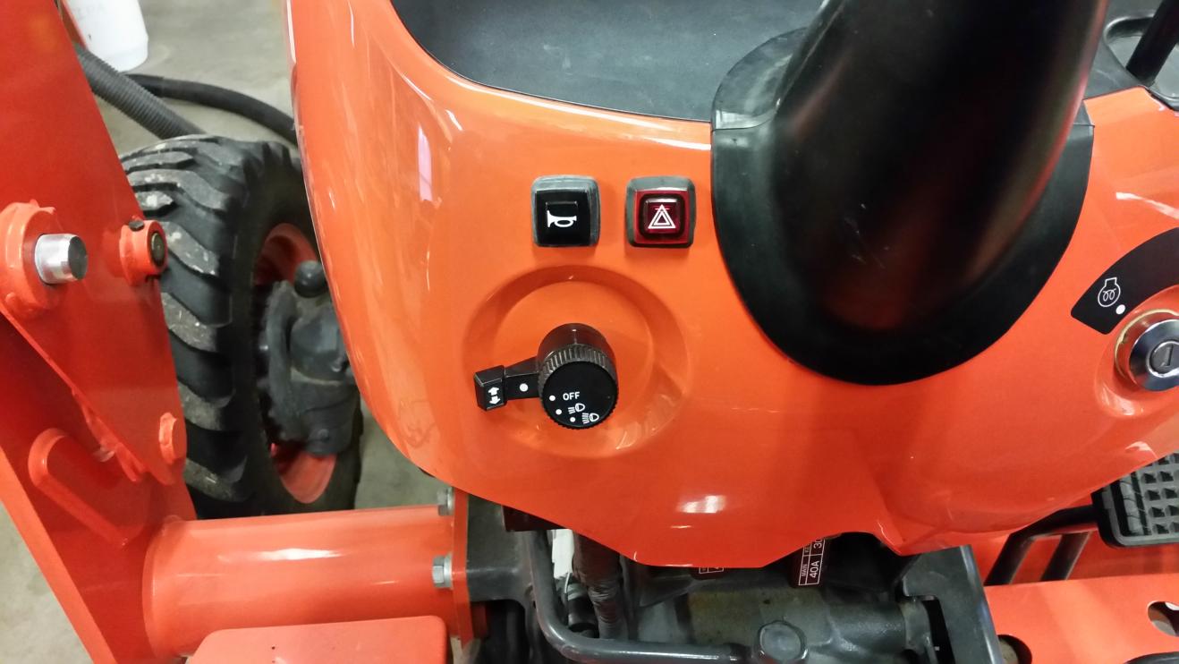

Looks great Number9. I did almost the same thing. What did you do for your connection to the factory horn switch? MESSICK'S told me they cannot get any wiring to connect to the switch, all I'm looking for is a pigtail connection. 20170322_115115.jpg

Drilled 1/8" holes in the corners, used a scroll saw blade manually to make a square like hole. Then cleaned it up with a dremel. I tried to sneak up on the proper sized hole instead of making the hole to big and sloppy. I didn't want the switch to rock from side to side when pushed on.
I stop by my kubota dealer today and he had a chassis wiring harness with some bad parts. We found the plug that I needed for my horn switch and he cut off 6" of wire with the plug. Awesome score for 5 bucks.
