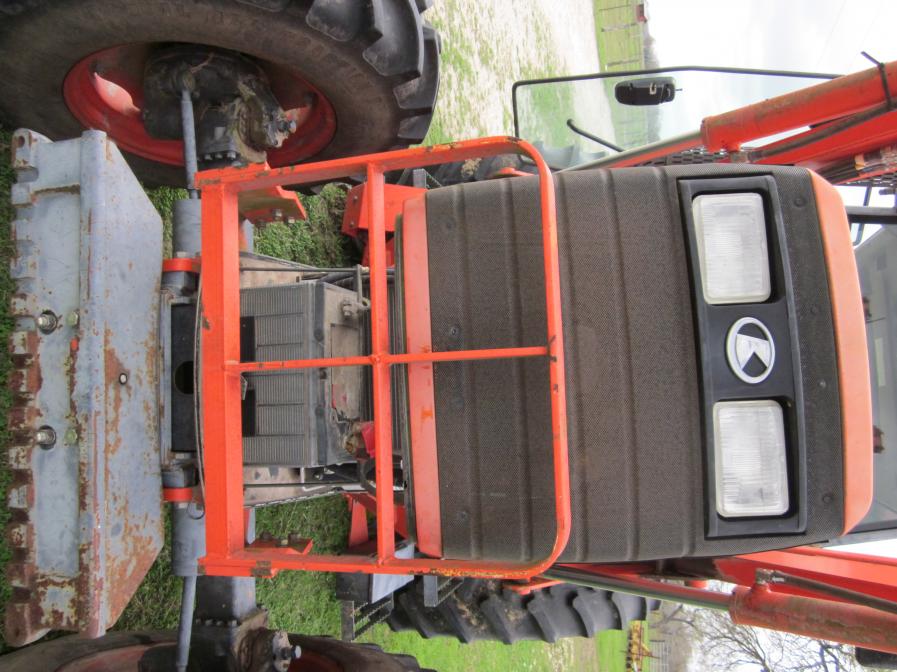

I agree that something has moved; but, there is no levers or pins that allow the grill guard to swing forward. It is fixed to the frame of the loader which is fixed to the Tractor Frame.
I believe I have found out how to attach a picture so here goes.
Picture #1 is the fixed attachment of the grill guard
Picture #2 is the hood clearance with the grill guard.
Thanks guys. Obviously something has moved but all the bolts are extremely tight on the loader frame as well as the grill guard, plus the loosened all the grill bolts to see if I could gain some clearance but no luck. It seems to be well attached and seems to be working as designed. I also .

I'd be checking around the hinge assembly of the hood. Check to see if upon close investigation if there are any signs of movement. Next I would see if backing off the fasteners a little and see if there is any sloop in the mount. With constant vibration, a fastener just slightly loose can elongate the holes they are in and can surprisingly change alignment.

I look at you first picture and see the three bolts holding the guard into the channel shaped metal. I'd say loosen those three bolts on each side, reposition the guard in the "groove" the re-tighten the bolts. Your guard in out of position, and moved too far back.

First off, I don't know why the picture orientation is different here that the copy on my computer; but, I guess you guys figured a way around poor orientation. Anyway, I loosened and actually pulled the nuts off the guard anchor points. Didn't help much. One thing I haven't done is pull the guard all the way off and open up the hood and give it a good look see. Before I did that I was actually trying to see if anyone that frequents this blog had ever had a similar experience. Since the local Kubota dealer shop people said it does happen quite frequently, I just wanted to really know why or what has taken place. One mechanic suggestion was to remove the bolts and put a washer on the inside between the frame and the guard. That should push the guard out ever so slightly which might be just enough. I will try that tomorrow and see if that helps and if it doesn't I will take it totally off and open the hood and see if anything has changed there; although the dealership said that was very unlikely. Anyway, back to testing mode.
