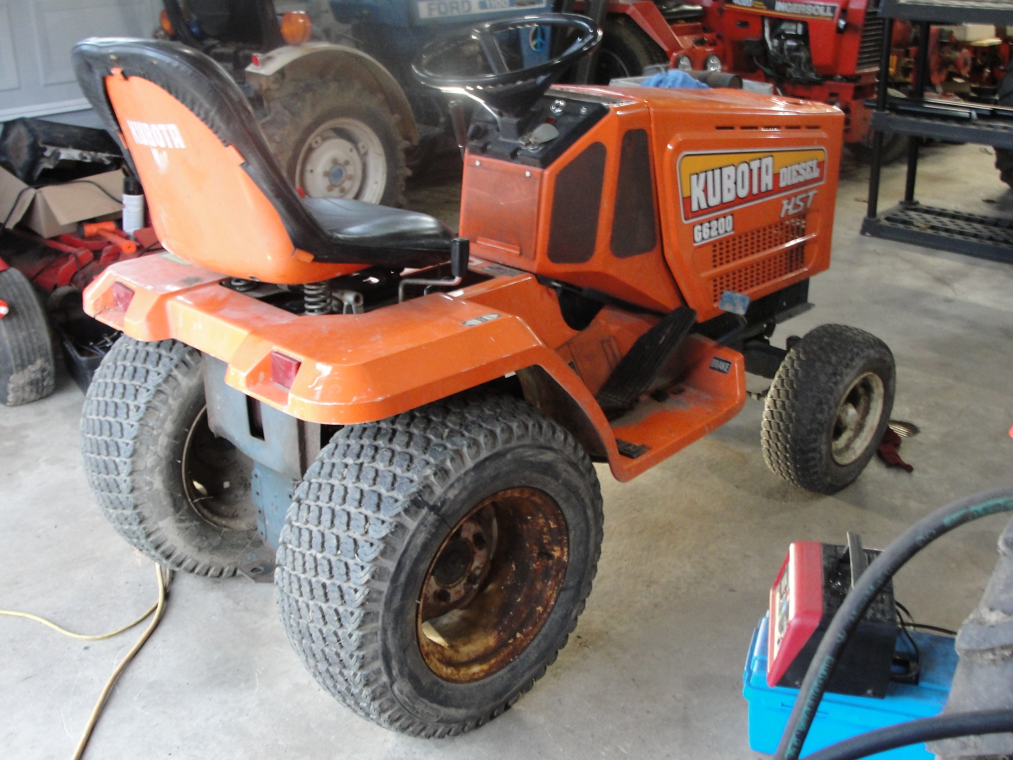

This is the first Kubota tractor we have owned and was hoping for some input and advice. The previous owner started it where we picked it up and drove it on the trailer. He had a hard time starting it and after several attempts and finally taking a battery from his own tractor it did start and ran quite well sounding good, no smoke or odd noises. We have other diesel tractors at home so we are some what familiar with diesel engines. The coil on the dash did not turn red so possibly glow plug problems? Anyways, he kept the battery, so I will need a new one and new battery cables as they are broken also . Tractor has not been serviced or taken care of properly although the oil is full but dirty. Can someone tell me the battery that belongs in this tractor? I found filters online and will be taking some photos this week to share. Aprox. 780 hours.

I put a new battery in it today and it started after a little preheat. The glow plugs must be working as after I held the key to the left for about a minute it sputtered and ran when started. i can hear something running... fuel pump maybe with the key on but still no glow or even warm on the coil on the dash. Attached ares some photos from today. I changed the oil so I could sleep tonight:D
