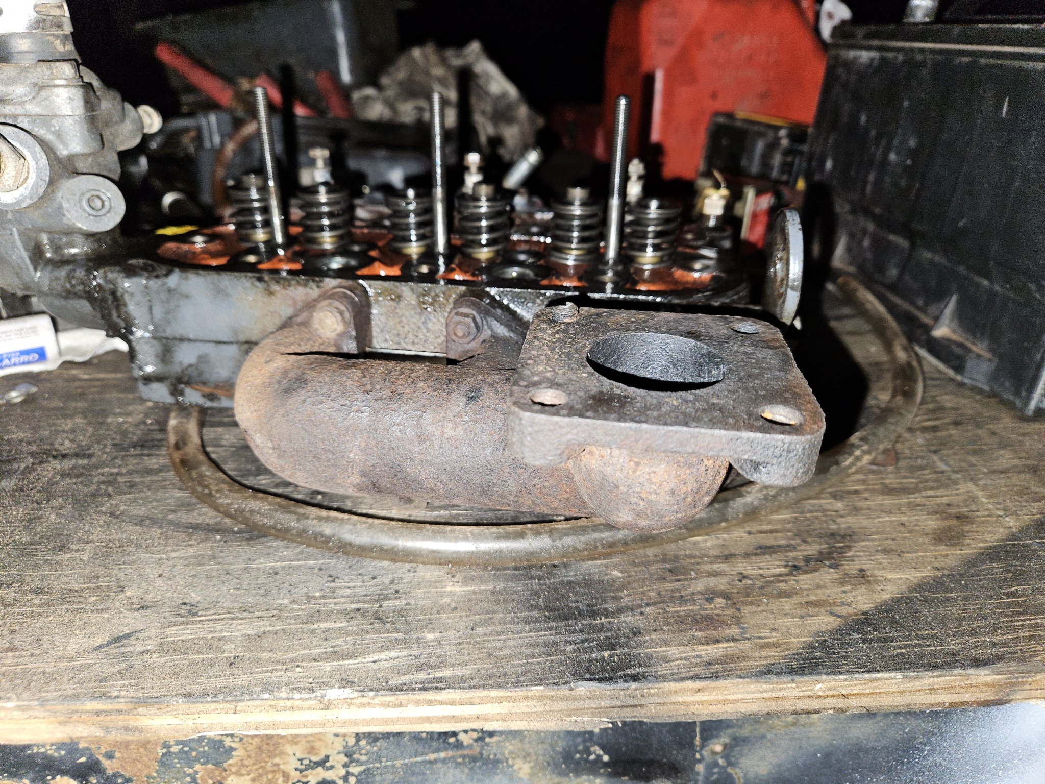

We didn't give it much ether. Just enough to hear it run on cylinder number 3. Once we heard it run on all 3, we stopped and decided to do a valve job. Nothing happened to the rings or anything else. The ether was only coming out in drops, literally. The valves were leaking when we first tried starting it, without ether. We hate using it but we did not want to buy anything else for it until we heard it run on all 3.
I wish you luck, but I'm curious how you decided the valves were leaking. Cracked head seems more likely from what I read.

We did a leak down test on it and air was coming out of the exhaust and intake valves.

I pulled the oil pan off and found out the rod cap was loose and the bearing got mangled. Needs rebuilt. The rings are shot. Any ideas on where I can get a good rebuild kit for it? The crank also has grooves in it from the bearing getting mangled.

Might need some more pictures of the engine like the exhaust manifold.
