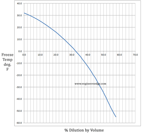

I just buy the pre-mixed 50/50 Prestone coolant and then a jug of concentrate and then I mix and test until I get it to minus 45*C protection. Then no worry's.
No need to test. That would be 12oz of concentrate added to a gallon of 50/50:
76/140 = 54.3% = -45F
