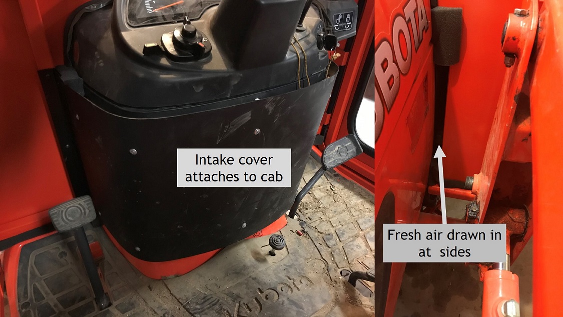

Not sure how the factory ones accomplishes this but, on my home brew, I've added a cover to block off air from the cab side and draw in from the cowl sides. I haven't looked at a factory BX cab but I'm guessing they would cover the screen below the dash and remove the plastic baffle below the battery tray to draw air from below.

Ping I have seen your cab build...very impressive! I would love to know more about how you block that air passage off! Do you simply cover the screen?
Thanks for the compliment. Cover is installed over the factory screen and fastened to the cab. Factory screen stays in place. There are a couple OSB ribs that space the LDPE away to provide the air passage. Those zinc plated fastener heads you see on the cover are their location. Left over packing foam is used top and bottom to close up the bigger holes. If you need more pictures let me know. Cab won't go back on until around Thanksgiving but, individual components easier to get pictures of now.

Thank you Ping! I see just what that cover is doing! No further pics necessary!
