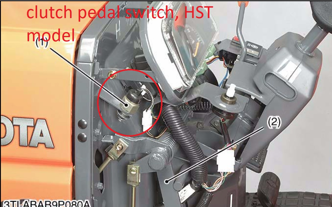

You need to contact a Kubota dealer in another part of the world such as UK if you want to find the switch you saw in the WSM.
Some alternatives for you to consider:
A clutch pedal switch for a L3130 HST model looks very similar to the brake pedal switch:
Places like eBay sell many universal brake light switches.
