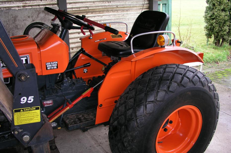

I used Tremclad "Real Orange" I did an A-B comparision and it was so close my wife could not tell the difference. Tremclad - $5.00 Kubota - $22.00. Click on the paper clip to see a picture.

I used Tremclad "Real Orange" I did an A-B comparision and it was so close my wife could not tell the difference. Tremclad - $5.00 Kubota - $22.00. Now I need a source for the blue paint. Any suggestions?
