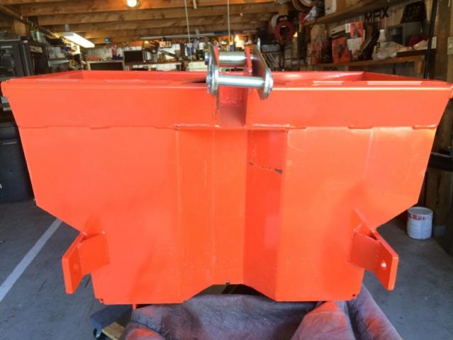

I just made mods to my Ballast box and thought I would share the pictures. The welder charged me $10.00 for material and I gave the welder $20.00! That's it and it works great. I primed with Rustoleum and then used Kubota spray match the color.
Pix 1 - a look at the original placement of the ears from the factory.

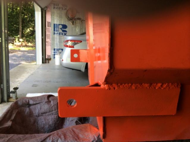

Pix 2 - Welder added a 1/2 inch piece of steel and from center hole of original to center hole of new add on is 4 inches.

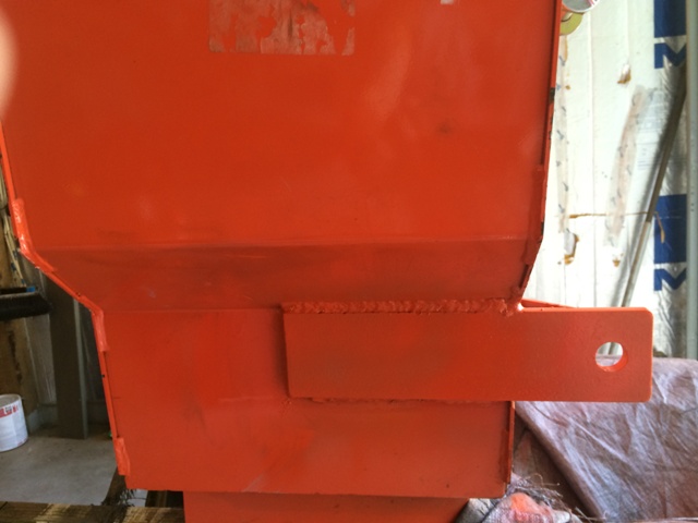

Pix 3 - view from other side

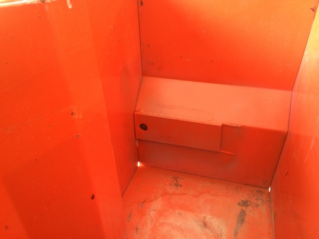

Pix 4 - View head on
