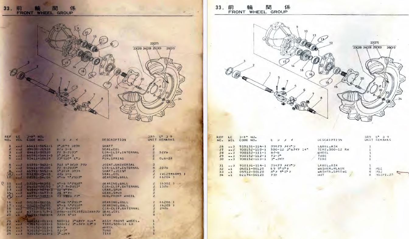

I need new cogs for kubota B7001 tractor on the front axle as completely worn so I need a spare part number if anyone can help please
34,467
9,721
You're going to need to describe what part you need better.
Your B7001 does not have anything called a cog.
rustydusty
Kubota B7001
Apr 15, 2024
Suffolk
A friend was checking the front hub and when he took it off the gearing inside is all worn.i know nothing about tractors at all! Perhaps it's called a sprocket? He said as no oil was in the gearing Box the cogs had sheared off
34,467
9,721
Sprockets are for chains.
You have gears with teeth. ;)
Count the number of teeth on each gear.
34,467
9,721
First thing @rustydusty is to make sure you have a B7001, a lot of people think they have a B7001 when in fact they have a B7100.
Can you give me the complete serial number that is stamped on the clutch housing by your left foot.
kaze
Kubota B7000 Cub Cadet 1782 Cub Cadet 78D York Three point rake Woods RM 400 mo
This is for the B7000, I have no idea how close if at all it is to the B7001?
