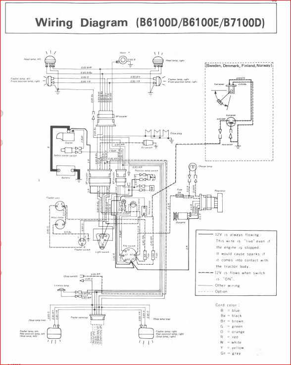

Try to explain what exactly you are looking for or what it is that you need to do.
Are you looking for where it goes? OR what each end connects to?
Here is a wiring diagram - see if this helps

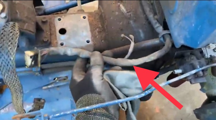

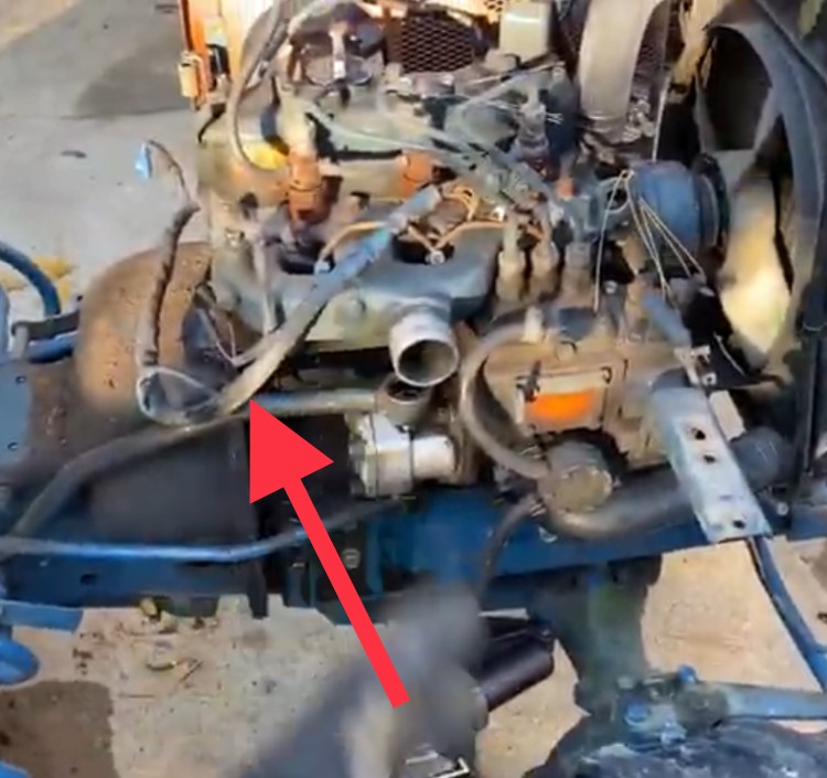

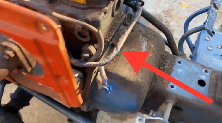

Many thanks for the reply
I look for the installation of the wiring harness, mine is completely distributed and impossible to recover.
I got the pictures of the thread on youtube, so I can explain what I'm looking for
