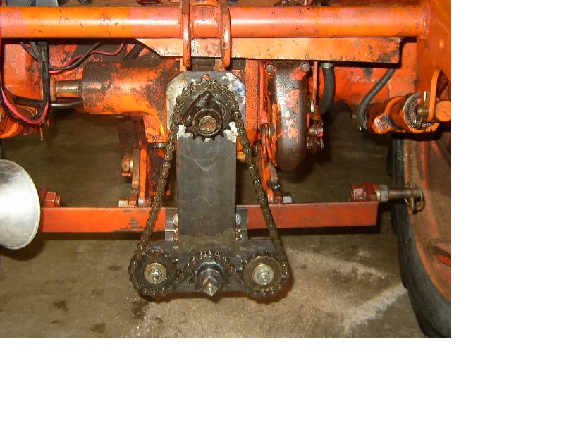

I came across this home made way to reverse a pto shaft rotation.
With the help of a machinist you may be able to do something similar for a reasonable cost.
The new pto output is at the middle bottom of the sprockets and chain. Because the chain goes over the sprocket the direction it turns is reversed.

Nice information addition to the board. to better archive that image am uploading it to the board

That is an ingenious idea for a home-made reverser.
I have a good friend I just talked to in Wallyworld yesterday. He has his machine shop set up at his house and was asking me if I needed anything built. Most of what you show in your picture is farm store parts and some welding. It might be big and ugly, but not $800!!!!! I may turn him loose.
