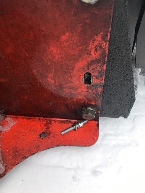

Okay I am having issues and the dealership has not been able to figure this out either.
I have a kubota B2650 and Snow Blower B2781B. There is a bolt in the side of my PTO gear box that is used to provide tension on the sprocket to keep the chain tight. And it keeps breaking. I had this happen last season (its 3 seasons old bought brand new). SO i talked to dealership got a new bolt, had to tear this thing apart to get it back together. Made sure everything was aligned and running. Mid season everything came lose again. I tore it all down and re tightened everything down and it was fine.
Jump to this season - first time out tensioner broke again and i had to rebuild it all again, and everything seemed fine. 2nd time out and the dam thing literally exploded with parts all over the driveway. Plastic casing on drive shaft shredded, broke the protective guards, broke chain and I assume its because tensioner bolt broke again under use!
So I filed a claim with Kubota Insurance and dropped it off for repair. Now almost 2000.00 in repairs and the second time I take it out to remove 3-4 inches of soft snow on my 1/4 mile driveway I senses a vibration, shut it all down and the darn tensioner bolt is broken AGAIN!
There has to be something I and the dealership is missing! What would cause that to break again? I am assuming some ungodly torque or force is breaking it. See pictures attached.
Does anyone have ANY ideas? I am desperate. In the middle of snow season and we have gotten over 40 inches of snow in December.
FYI - Now dealership wants me to get machine and snowblower into the dealership. At My cost! I do not have a trailer big enough and would cost over $200.00 each way!
I am so freaking irritated. Been out of work since June. I purchased a grading pusher blade a week ago to get by (1800.00) but now they want the whole kit and kaboodle! I'm screwed!!

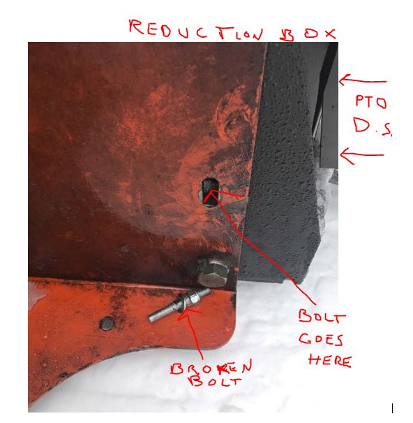

Here is a diagram. I have marked the location where the tension adjustment bolt location. This bold pulls the housing assembly to provide the proper chain tension.
That is the bolt that keeps breaking.
Added pics I have notations on!

I just brought an older model of the same blower home yesterday so I am by no means an expert on this. I just went and looked at the adjustment bolt on mine. Please don't take my observations and comments wrong I am only trying to cover all the bases here.
Once the chain has been tensioned with that bolt, 4 other bolts- 2 on top and 2 on the bottom of the reduction box should take all of the strain of the blower operation.
Adjusting of chain should be.
A. Loosen 2 top & 2 bottom bolts
B. Adjust tension bolt to achieve correct chain tension
C. Tighten 2 top and 2 bottom bolts.
The bolt that keeps breaking on your blower should not have any pressure on it in operation. In fact you should be able to remove it and not affect operation after the chain has been tensioned. You don't say what happens to the 4 bolts that should keep the chain in the correct tension while operating. Are they shearing off also?

I adjusted my chain on mine. There are two bolts on top to loosen up also the side shield need to come off to allow access to tighten the adjusting bolt. Tighten chain and check tension then tighten the top two bolts and should be good. reinstall the side cover of chain. Hope this works out.
nbryan
Jan 3, 2019
1,302
825
Hadashville, Manitoba, Canada
Loosen the bolts that jhold the tension just enough to allow the gear box to move. Adjust chain tension (with that screw that keeps breaking) so that the chain has the 1/16" play needed.
Check for chain play while slowly hand rotating the sprockets through several turns of the large sprocket.
There will likely be a noticeable lossening/tightening of the chain as it's rotated, as mine are it seems not perfectly round and the 1/16" slack can be taken up by that, and cause chain tightness at certain points in its rotation. Make sure there's ALWAYS that 1/16" play MINIMUM at all times while turning the sprockets.
Once you're satisfied it's not binding and the locking set bolts are re-tightened the adjustment bolt can be backed off slightly as it's not involved in holding the tension.
