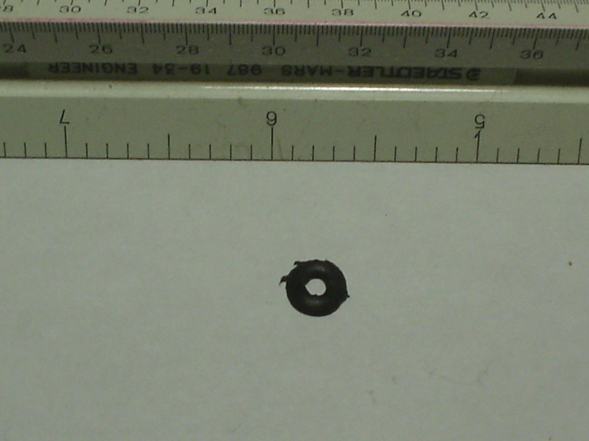

Here's what made my BX23s 'run real rough'........ 1/4" half bagle shaped piece of plastic in in the tank, found that AFTER changing both fuel filters......sigh. I have NO idea what it is or how long it'd been in the tank, it finally just bounced or floated to plug the drain hole.......
