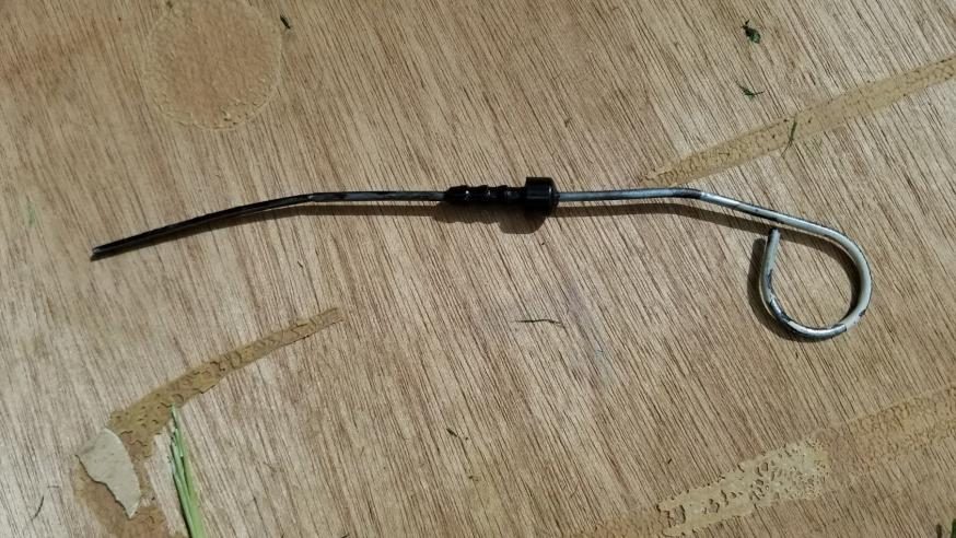

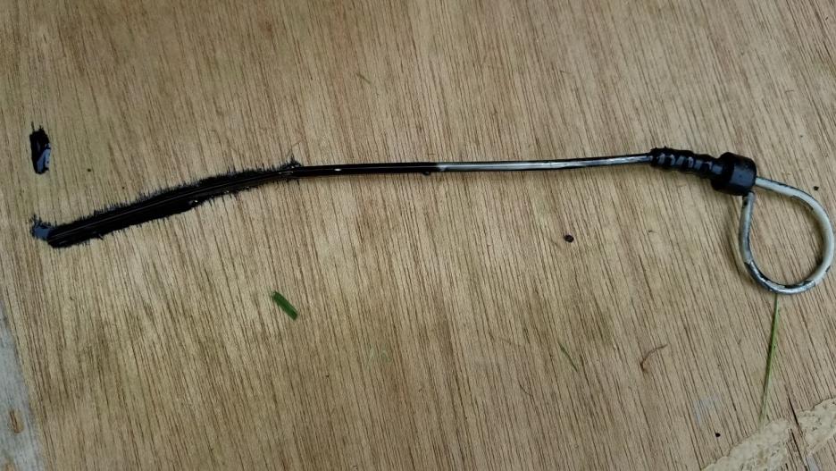

Just got a B20 and doing an oil change before putting hours on it. Drained the oil, surprising little came out, est 1-2 quarts. Specs says 4.1 qt capacity. I changed the filter and added 4 quarts. I started the engine, let idle, then checked the oil level. It is very overfilled according to the dipstick, like twice as much as it should have. I am not sure what to do.
First I double-checked that I drained from the correct spot and yes, from the bottom of the oil pan. The pan seems small. Not sure if I should drain and re-fill according to the dipstick or just call it good with 4 quarts.
Advice??

I can't tell you what you did or didn't do, it's pretty strait forward on that model only one drain plug.
Now I do know that the stop on the dip stick rod can move and give you a false reading.
Pull the dip stick and see if the rubber stopper moves, if it does get a new dip stick! ;)
Might even post a picture of it just to make sure. :)

Spend some buck$ and get a new one as NIW mentioned, less grief in the long run, especially if anybody else uses or checks it.

If your not going to purchase a new dipstick, you need to be positive you have the correct volume of oil in the pin, then mark where to top of the rubber stopper should be. You can then rough up the steel rod, clean and use some JB weld to keep it from going up again.

Yeah, I'll mark the dipstick for now and start looking for a new one.
It has certainly been running very low on oil for who knows how long. I did not notice the oil light on before and did confirm it works when starting after oil change. Hopefully no damage done, ... I'll go measure the amount of oil that was in there ...
