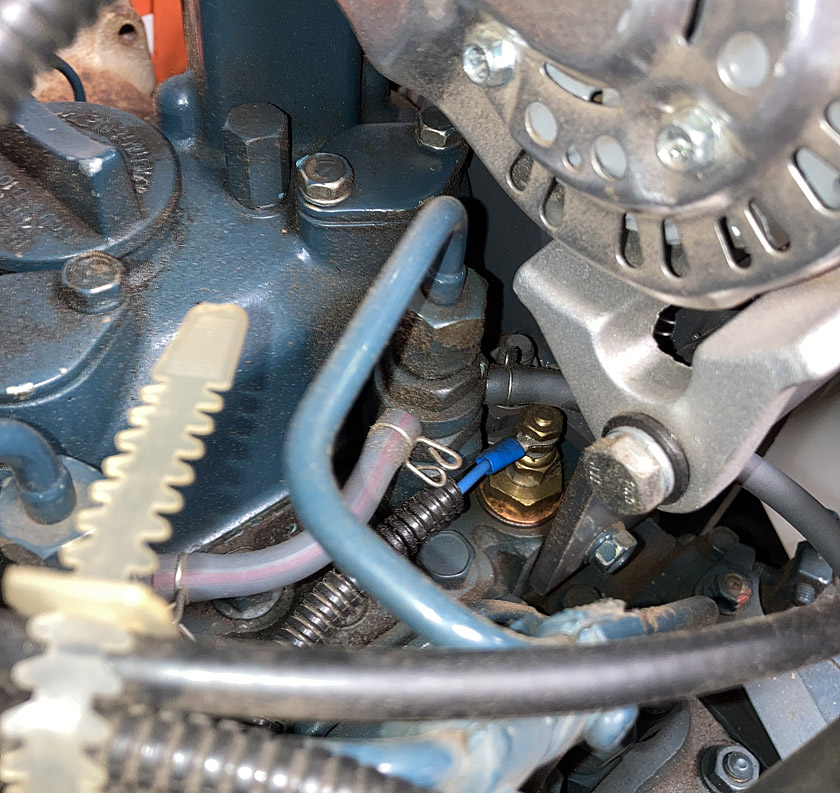

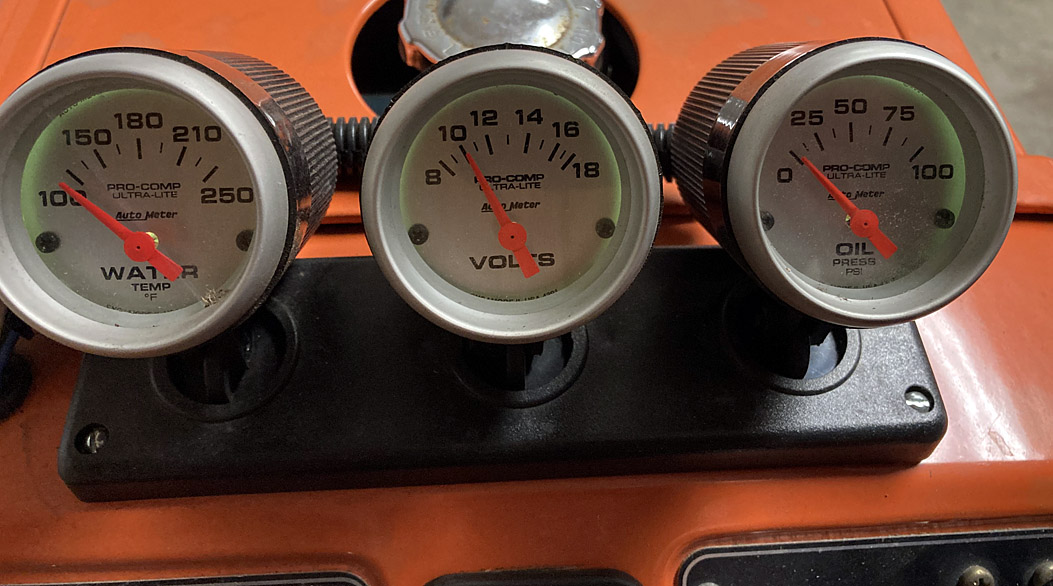

I run a trio of Autometer gauges on one of my 7200's. For the water temp, I tapped a plug on the cylinder head near the front most injector. I did it a while ago, so I don't remember the exact size, but I believe it was a M16x1.5 or something close to that. It was definitely not a tapered thread though.
I teed off the oil pressure port in the block to a remote oil pressure sensor. If memory serves, the oil pressure port is a British taper. All the gauges are electrical and they've been working good for a few years now.
Thank you for the input. I'll have to figure out how to share photos on this site.... I'm doing the same as you for the oil sensor except mine is electrical. As for the temperature sensor, I have a plug already in the thermostat housing that I am going to drill and tap for my sensor 1/8 NPT
The oil pressure sensor I run is all electrical. You're limited with room everywhere on these small machines, so they make the most sense to use.
