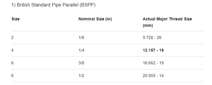

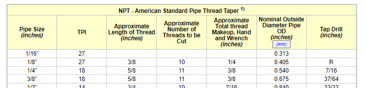

Hi Wolfman; (B200) finally got around to installing my temperature sensor in the plug on the thermostat housing. I thought I had all the fittings required as my sensor came with a variety of fittings. I have a problem as the BSPP fittings that came with the sensor are all course threads, 14 threads per inch i think. The threads on the plug are much finer, looks like 24 TPI. I have been checking all over the internet with no luck finding one. Can you please confirm the thread for me and do you have any suggestions where I might find one. I am considering drill and tapping the plug for 1/8 NPT. Any thoughts would be appreciated.

Are you sure it's 1/8"?
Most of the plugs I've seen in those housings are 1/4"
If it is 1/8"
Simple option 1/8 pipe NPT tap.
Or this fitting:
If it's 1/4"
Again you could do 1/4" pipe NPT tap.
or this fitting:
Sorry been a while since I've dealt with one of those housings, and I don't have one on hand to look at.

Sorry for the confusion. The plug threads are a Male BSPP - 3/8 - (24?) x Female 1/8 NPT
For the male threads, I counted the threads over 1/4" (6 threads) - 6x4=24 TIP. If you look at the #6 above that you listed, it is 19 TIP and that I have but it is a course thread compared to the plug in the housing. It is much finer.

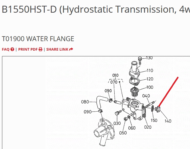

The plug part number is 34150 - 36730. I suppose Kubota uldnt identify by drawing?
