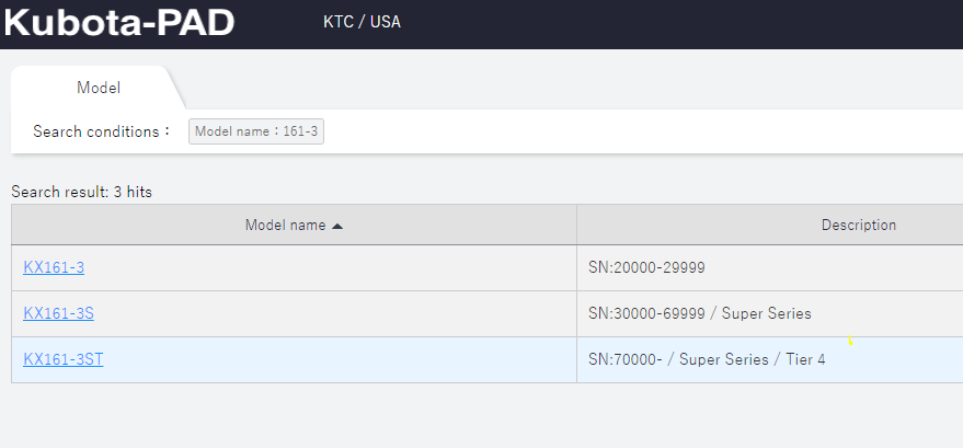

FYI: Can possibly give you better answers if you give me the serial number.
As there is not a KX161-3SS.
There is a
KX161-3
Kx161-3S
Kx161-3ST
And the fuel system is different between all those models.

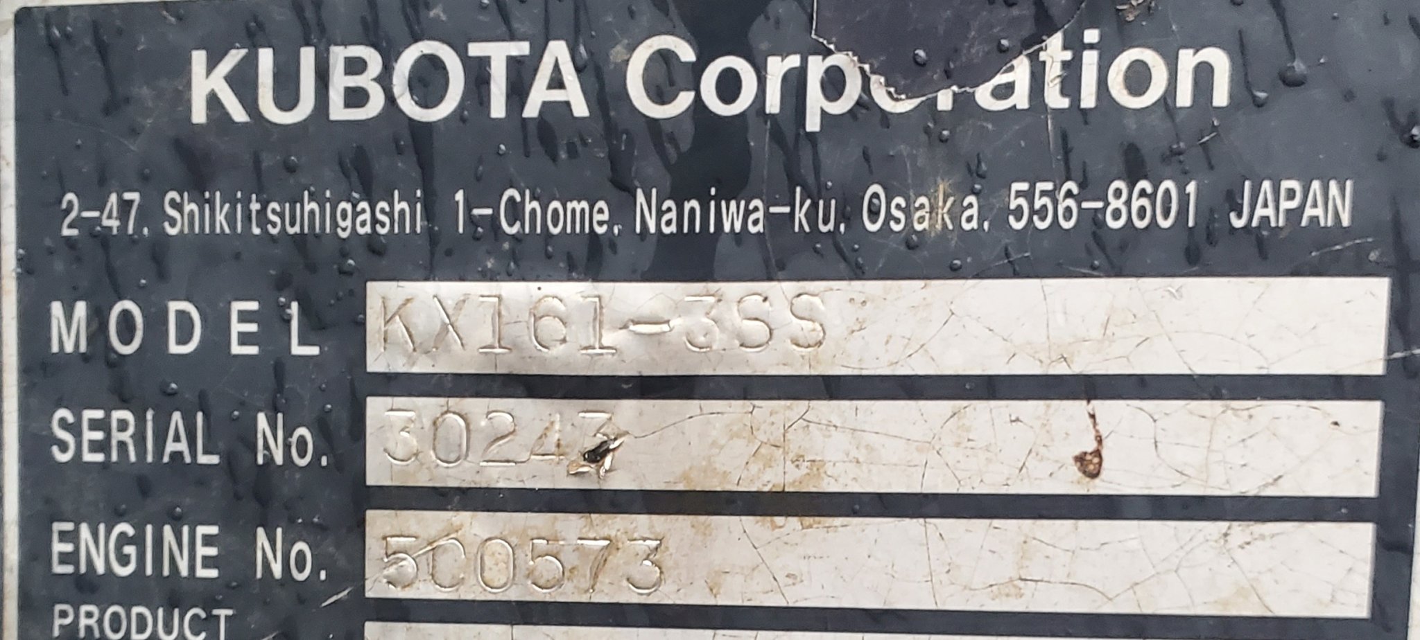

Here's a picture of plate View attachment 93499
Thanks, got to love Kubota's inconsistency with product names and documentation names.
So it's a KX161-3S for parts and build info.
And as Rentthis said, that style of separator is know to have loose fitting on it, so check that too.
