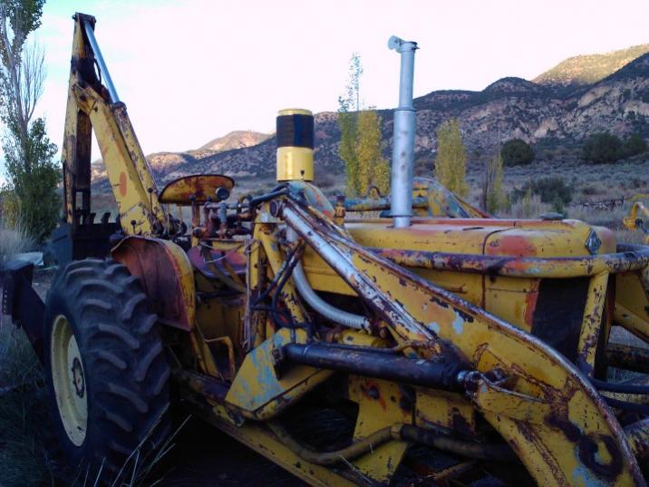

Also, my D-17 has no safeties either and while it's convenient for warming up, it's not safe by any stretch. A front wheel of it alone weighs over 150lbs. You cannot make ONE mistake with it or it will seriously maim you. (See picture for the hardware attached to the monster)
Please be careful!
