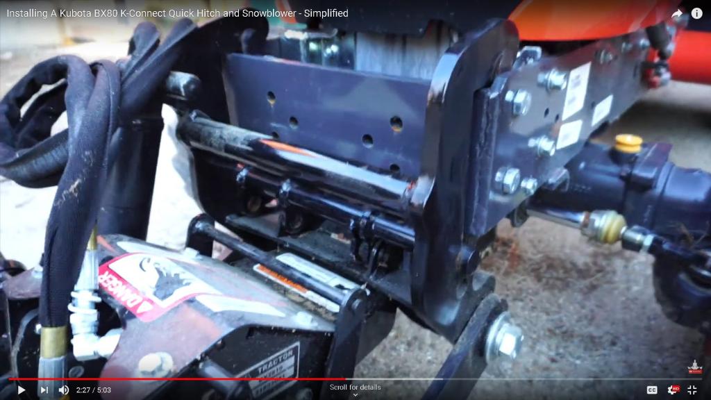

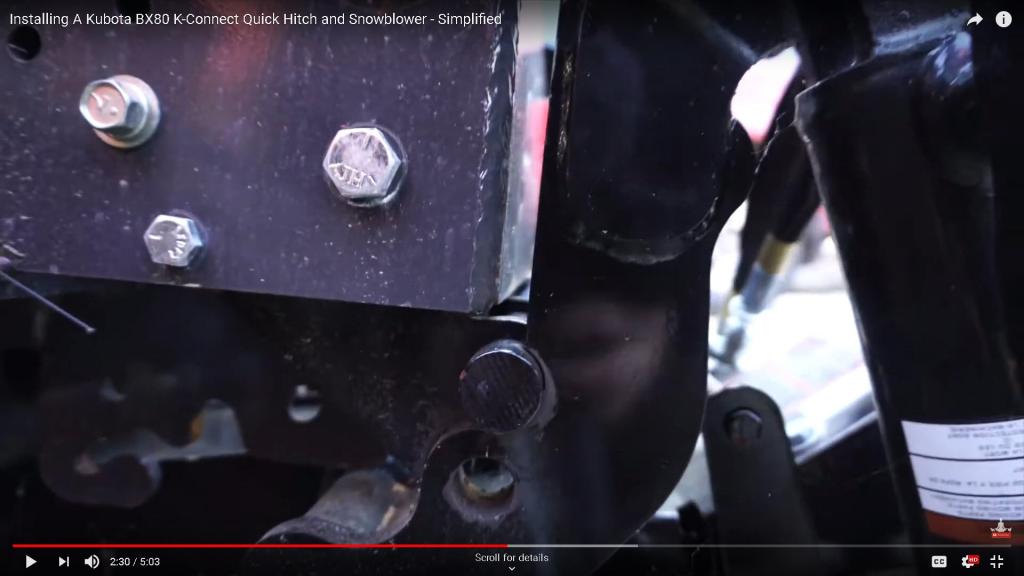

So a little more research leads me to believe the BX2810 K-Connect hitch can be installed on my 2230 with a modification to the frame rails.

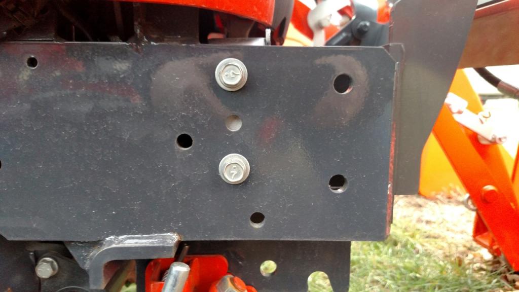

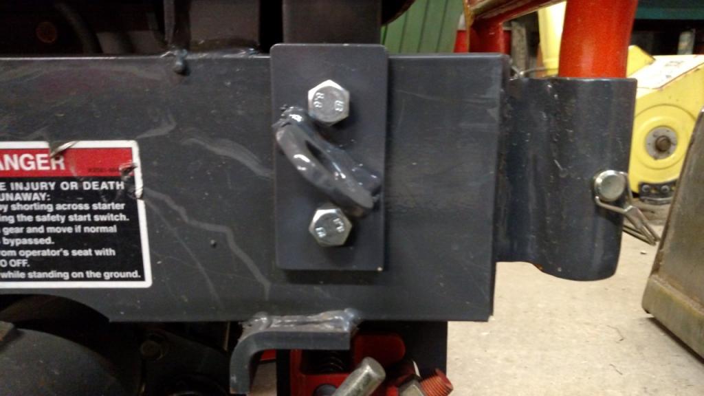

As you can see in the pictures, the later BX frame rails are longer in front of where the front grille supports bolt into them. The inside dimension between the frame rails is the same on both models. I'm going to go back to the dealer a make some precise measurements on one of the BXs on his lot so I know just exactly how much it needs to be extended, but it looks like a couple of inches. Other than needing a few new holes to be drilled, I don't see any major engineering problems.
By cutting the front plate off the frame, I can fabricate a piece to extend each side of the front of the frame the needed amount. Those can be jigged up and welded in place, and a reinforcing plate maybe 6" long welded and bolted over the joint. Since the adapter for the hitch only bolts to the inside of the frame, it should work just fine.

Why not just build a steel box in the dimensions that you need to extend the frame and bolt it onto the existing front frame panel. If your frame is anything like mine, it already has the holes in it to bolt your new frame extension box to.
That's a good idea. I would still use a plate on each side extending back a couple of inches and bolt it to the original frame rails.

Then, you will need to double up the side plates, and if you are concerned about strength of the addition, drill the outer plate, and plug weld it. You could also bevel the 2 edges to create a V and then weld the two plate together that way. Lots of ways to do this, but I don't believe that the extra side plate would be necessary, if you were to bolt the 2 pieces together using grade 8 flange bolts and nuts.
