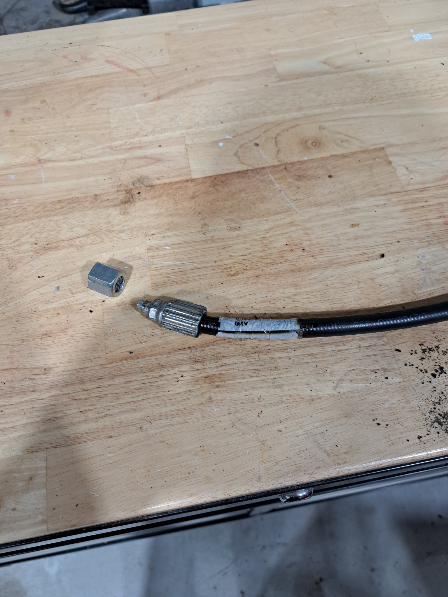

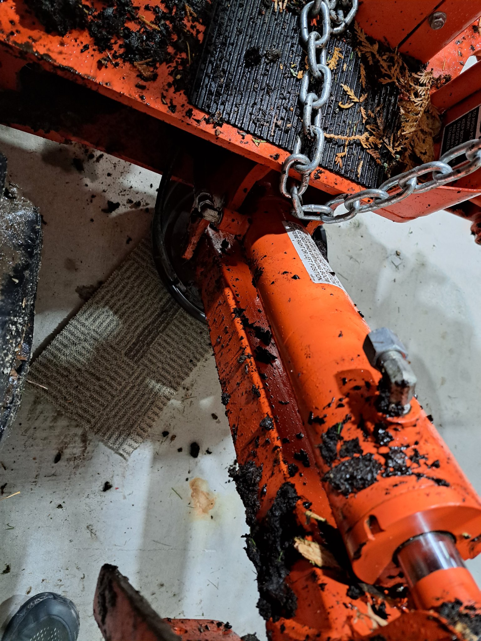

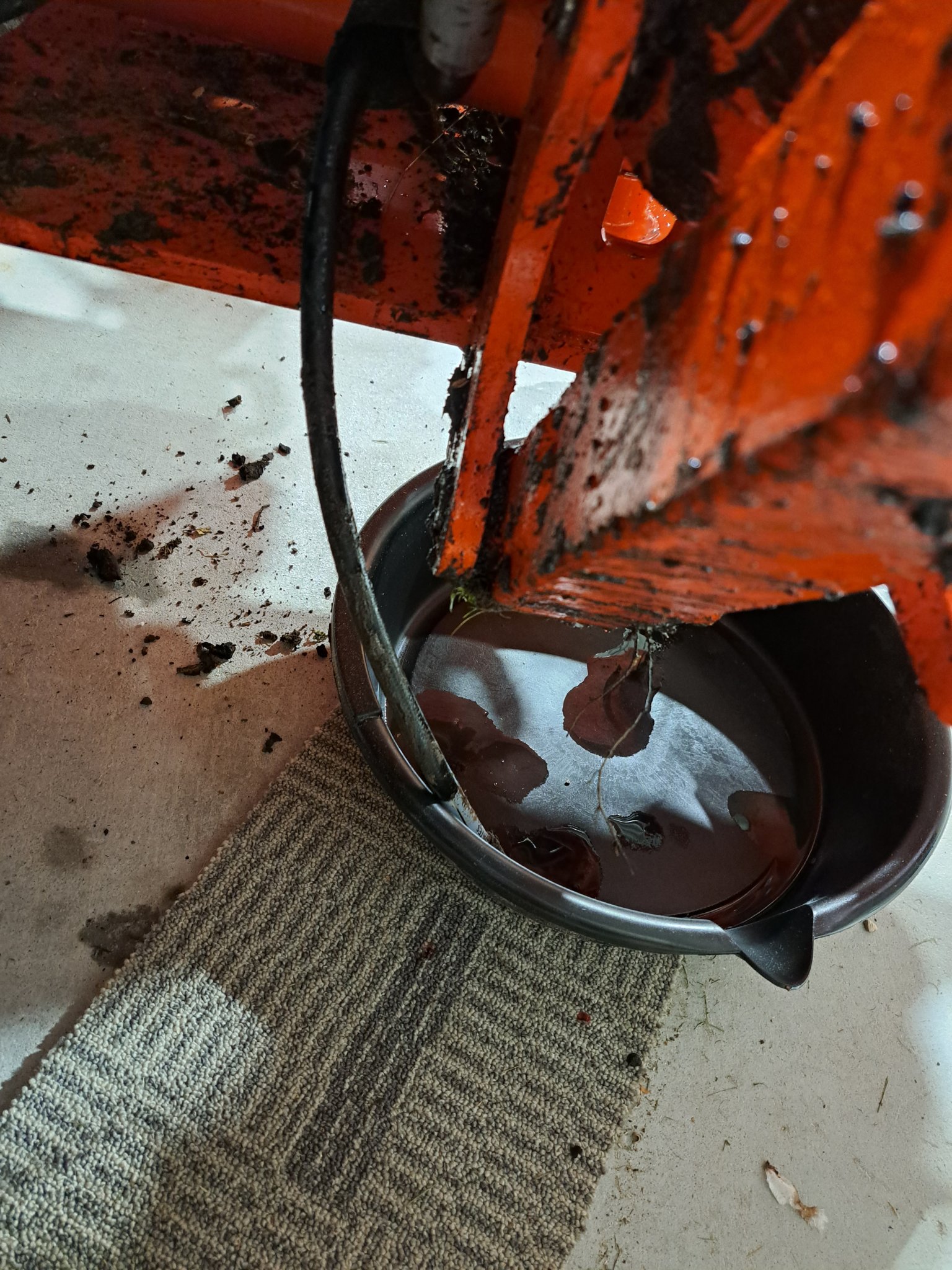

yesterday, at some point, a branch must have "grabbed" the hose and it snapped off the "top" of the outrigger (port side)
So I go to lower it and get a nice little "douch'ing" of "red SUDT 2" down my leg.
So after a cussing session the whole ride back,
Here she is after removal.

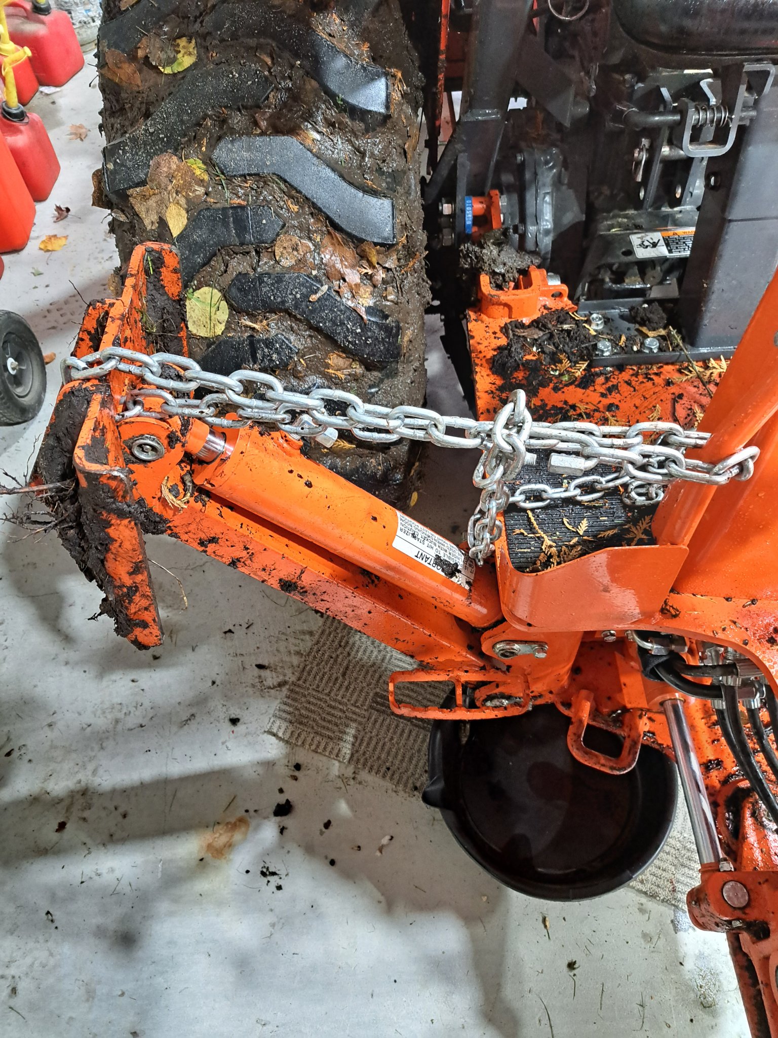

Now the SOB'ing outrigger won't go up and I don't want to damage it by hitting a tree or something, so in the pouring rain, I grab the chain I was using as a "choker" and give Stonewall a splint, and limp him home.
