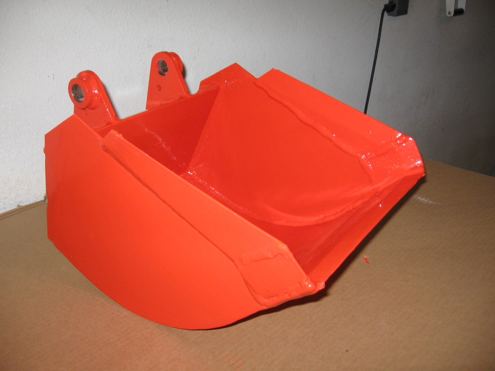

Used the same paint on one of my buckets.

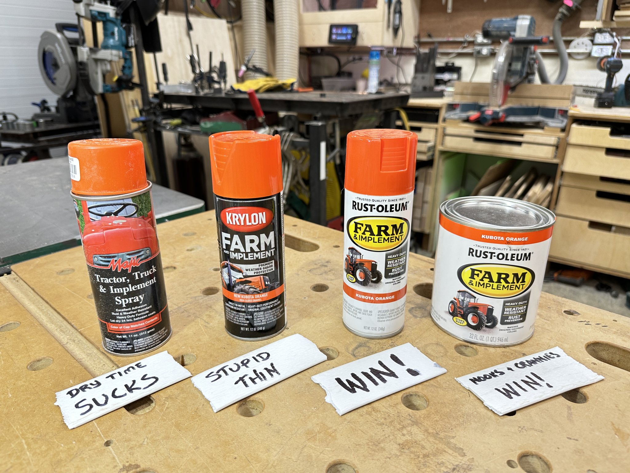

Analysis:
  1. Majic: senseless. Stupid dry times, like 24+ hours PER THIN COAT. Should have read about it online before buying it to try to face $6 over the Rustoleum. Major waste of time.
  2. Krylon: THIN coats. Dries fine. But 7 well-shaken coats on steel == transparent orange. (On white, however, the color starts to show sooner. Major waste of time.
  3. GREAT! Though the vertex effect or whatever prevents the spray from getting into nooks and crannies
  4. FINALLY. Thick. With a thick bristle brush (I used an acid brush) it dabs deep into the nooks and crannies left behind by broad spray #3. Dries fast and vibrant. I’ll use this for 90% because opacity is excellent
TL;DR:
#1 and #2 = landfill
#3 and #4 = keep on hand.
Oh; and the UX painting but hits me hard always, though sometimes delayed. I’m surprised it took this long. YouTube “Paint Your Flipping Bits Already” to see my partial philosophy on painting stuff to find stuff. 🤓

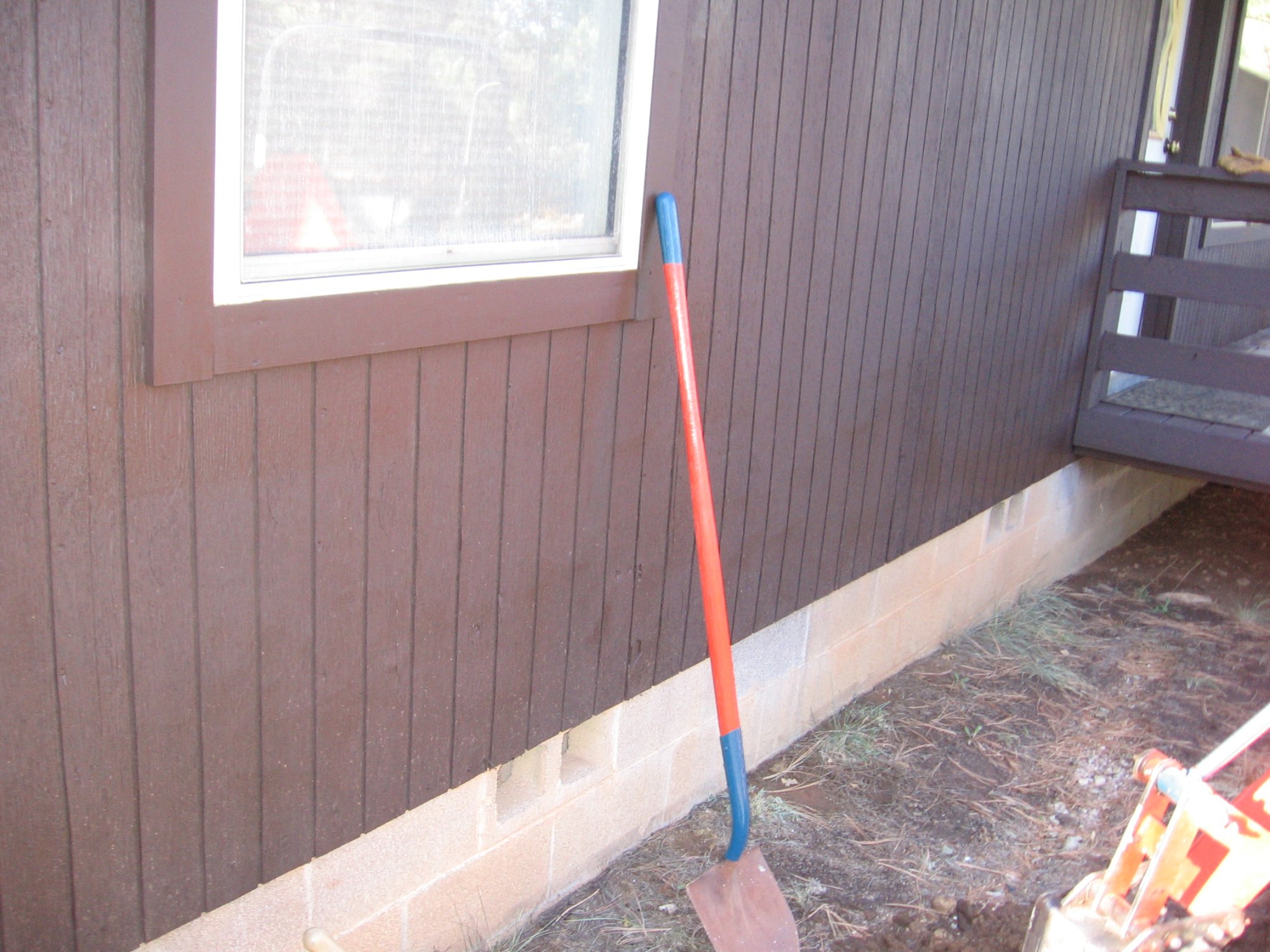

I see this as a slippery slope- where do you stop?
Screwdriver handles, hammer handles, wrenches, dog's tail, garden tools?

and to answer your Q: I rattle canned (#3) the thing, then I ordered the can (#4) to jam into the crannies.

AND that Majic paint FADES BADLY. BTDT.
Rustoelum is the WIN for sure!
