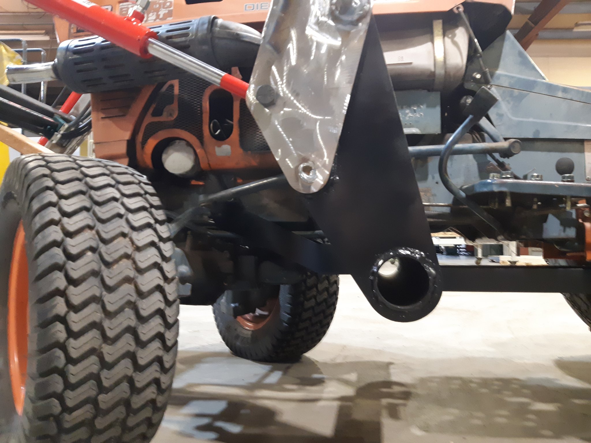

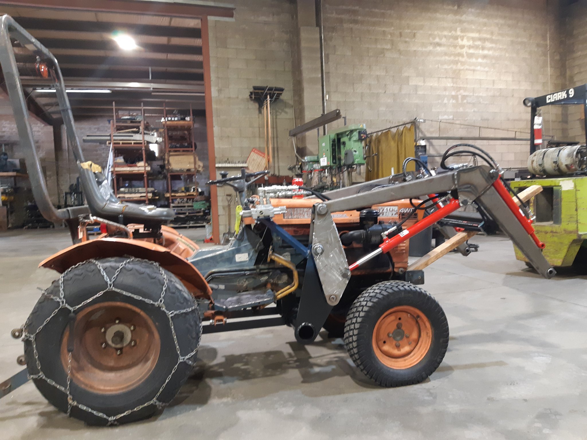

Hello Everyone,
Sorry for the long time since the last, life gets busy.
Additionally, the sharp increase in the price of steel has pretty much scuttled the idea of doing a for-sale kit.
Nonetheless, I wanted to share a couple of pictures of my progress:
Fab is almost done, plumbing is done. All that's left is to make stands for detaching it, tie the hydraulics in to the tractor and then take it all apart to prep it for Powder Coating. I'm thinking either black or orange, but am open to suggestions.
There has been some interest in the subframe:
I used mostly the same attachment points as what the B219 loader that originally came with these tractors, bracket to rear axle, the 3 bolt holes just to the rear of the bellhousing, and the four front subframe bolts just over the front axle.
