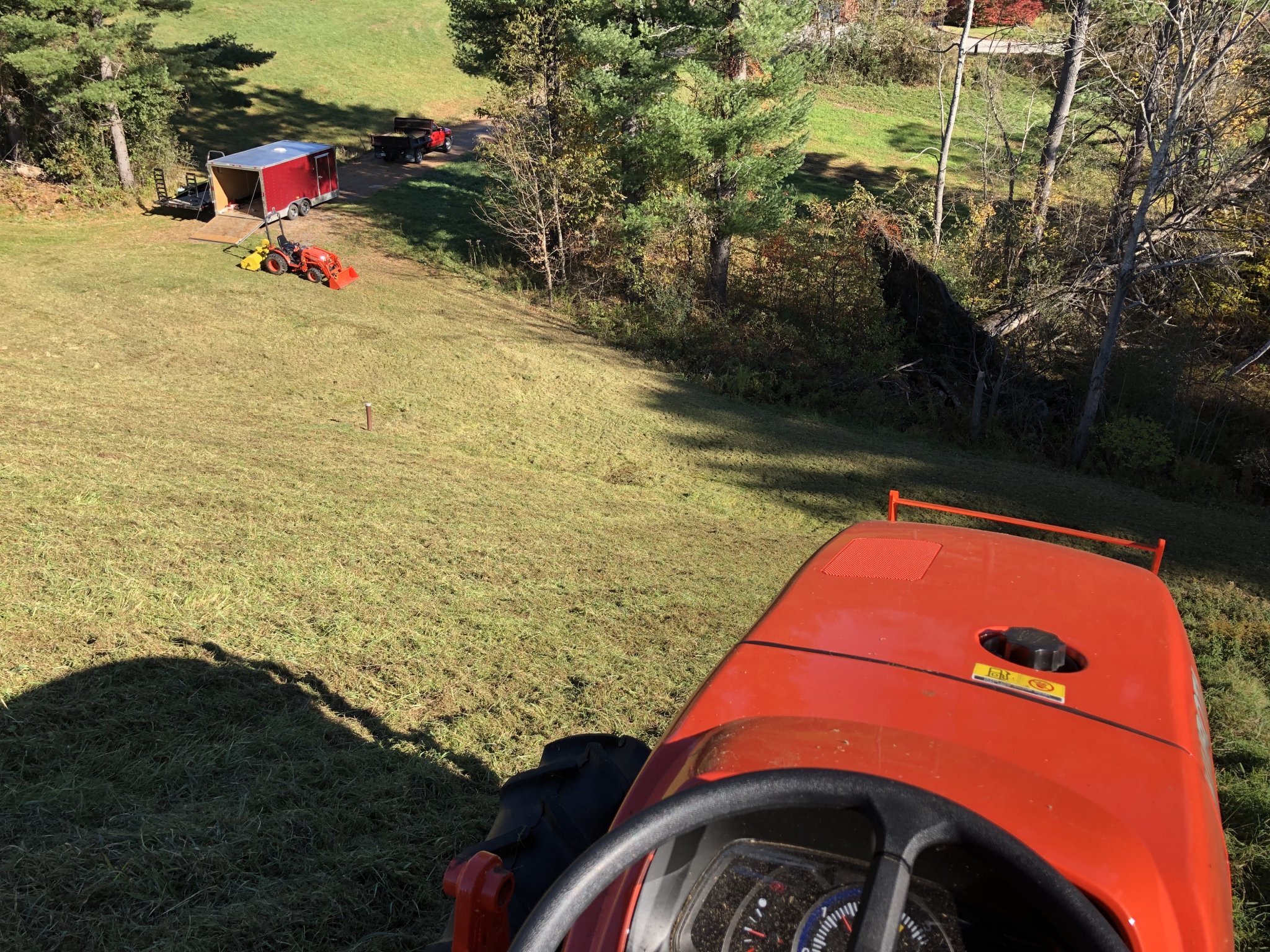

I mow a few dams. Here's one to give some perspective about a very steep dam with not much room for error. Back up with a flail mower raised; mow down. No loader attached as its too steep to back up with the added weight on the front. In this shot I'm doing it with an MX4800 but I have done it with the little B2920 at the bottom as well. Keep your tractor perpendicular to the top of the slope. If it starts to slide, be prepared to change directions to forward (downhill) immediately. Do not allow the tractor to get sideways at all, or you might die. Different grasses offer different levels of traction. Ferns are very slippery. Beware of morning and evening dew. The first time or two will stress you right out. I've done this property 7 years now, and I'm not bothered basically at all anymore. This is steep enough to where driving up would not be possible.

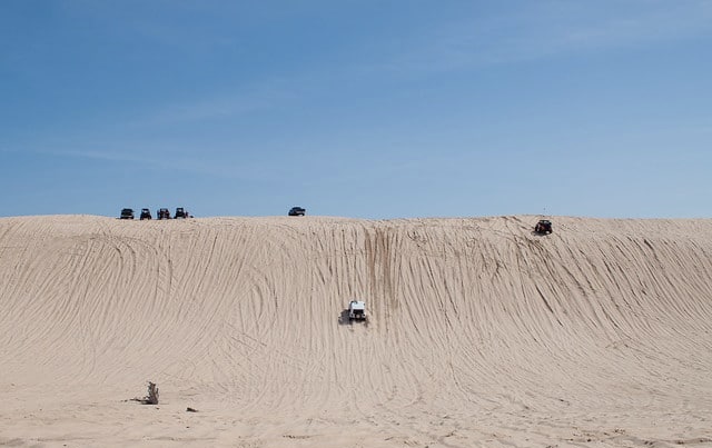

Wow! That is one scary slope. And I thought this dune hill at Silver Lake State Park in my truck was crazy. Goes to show you “one man’s comfort is another’s crisis”

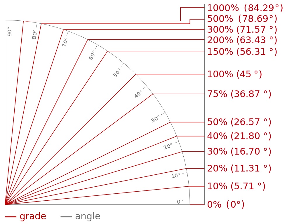

For posterity, if anyone views this thread in the future, a visual look at degrees and percent slope.
BigG
Sep 14, 2018
1,951
774
West Central,FL
Could you explain where these numbers come from? 5.71 degrees is 10% of what? 45 degrees is 100% of what? I am not saying this is wrong rather, how did they come up with the numbers?
bird dogger
Vendor Member
Feb 24, 2019
1,720
1,670
North Dakota
Perceent of slope is the vertical rise divided by the horizontal run x 100. Thus, 1' rise in 10' horizontal run = 1/10 x100 or 10%
The angle comes from simple trig function: opposite side / adjacent side (of a right triangle) = tangent of .1 which is 5.71 degrees (where opposite side is the height and adjacent side is the run of the right triangle.
In a 100 % slope: 100 ft run with 100 ft rise.......100/100 x 100 = 100% slope
The angle: opposite over adjacent.......100/100 = an angle with a tangent of 1 which is 45 degrees.
