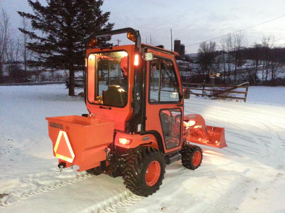

Ok - think of it this way, you have a good deal of weight behind the front end under normal circumstances - but when you place a snowblower (500 lbs) or you have a load of gravel in the bucket - ALL the weight is NOW transferred to the front end.....with a ballast box (400-600 lbs) you are now placing more load on the rear end, and better stability and grip. Next time you have a full load in the bucket, raise it about 2' off the ground and then move forward and then stop suddenly, you will feel the rocking effect - now do the same with the ballast box, still there a bit - but much more stable.:)

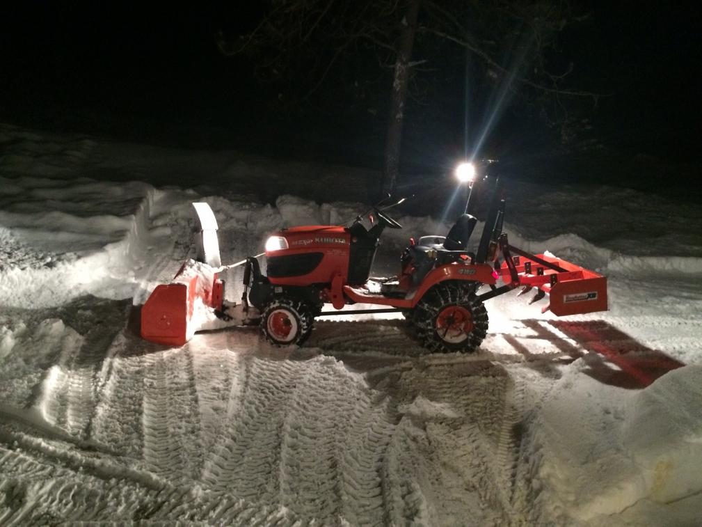

Used my BX2360 w/snowblower, loaded tires, chains 2 years without anything out back. Struggled on steep parts of the driveway and lawn. Do some lawn for the dog. ;)
Last year, carried boxblade and it helped, but it does stretch it out.:)

I also have a BX2370 with a BX5455 blower. My rear tires (turf tires) are loaded and I carry a rear blade all winter. A rear blade in combination with a snow blower works really well if you have snow removal around building. You can drag the snow away from the building and then blow it away. There are several options to keep the blade from damaging your blacktop. I use the blade backwards and cleared some of the lawn with no damage. With loaded turf tires and a cheap lite weight rear blade I have never needed chains and I push the blower up a 9 degree hill.
