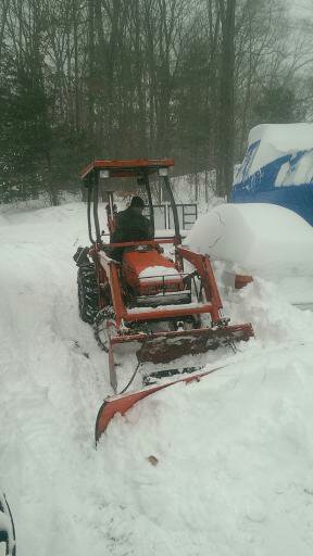

Thanks, Front spins. I have a steep asphalt driveway and run chains in winter. I just wondered if front was limited. I have never had it back to the dealer, always try to do my own maintenance. This has just been oils and filters. I did wear out the front tires. 1100 hours. The last couple years it has been used more as a skidder than a tractor.
