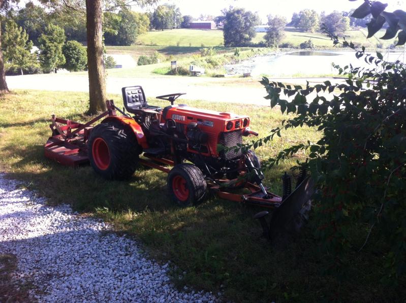

I am attaching 2 pictures of the blade and one picture of the tractor with the blade on it. Sorry they are at odd angles, I took them to use to track down what kind of blade/setup this was. The blade has hydraulics that move it up and down, but it can be manually turned side to side, or can be left loose on one side (which it is now) so that when I push anything it has some give and moves it to the side.
Thank you two so much also for the kubota parts list link. That is fantastic. This blade has KUFD210 stamped on it, and I have searched Kubotas Official parts list for older B series and L series tractors and haven't found anything yet but I am still looking. I found a KUFD110 manual on ebay, but no such luck for the KUFD210 yet.

Ant126, the KUFD210 (manual angle) and the KUFD110 (power angle) were the first blades offered for the B51, 61 & 7100 series tractors. Sometime after a different blade replaced it, the 2020 & 2030. There are apparently two different front mountings for the lift cylinder; yours in which the cylinder is angled forward, and the one I have, in which the cylinder is almost vertical.
I wouldn't spent a lot of time looking for manuals. because there are no parts available from Kubota, other than possibly seal kits. Dealers catalogs do not show the KUFDs even exisited.
I do have an extra front blade, cylinder mtg bracket and front frame pivot.
Good luck, Roger

Or you could replace the solid rod with a cylinder and have a power angle blade. I wish the BX blades were built like that.
