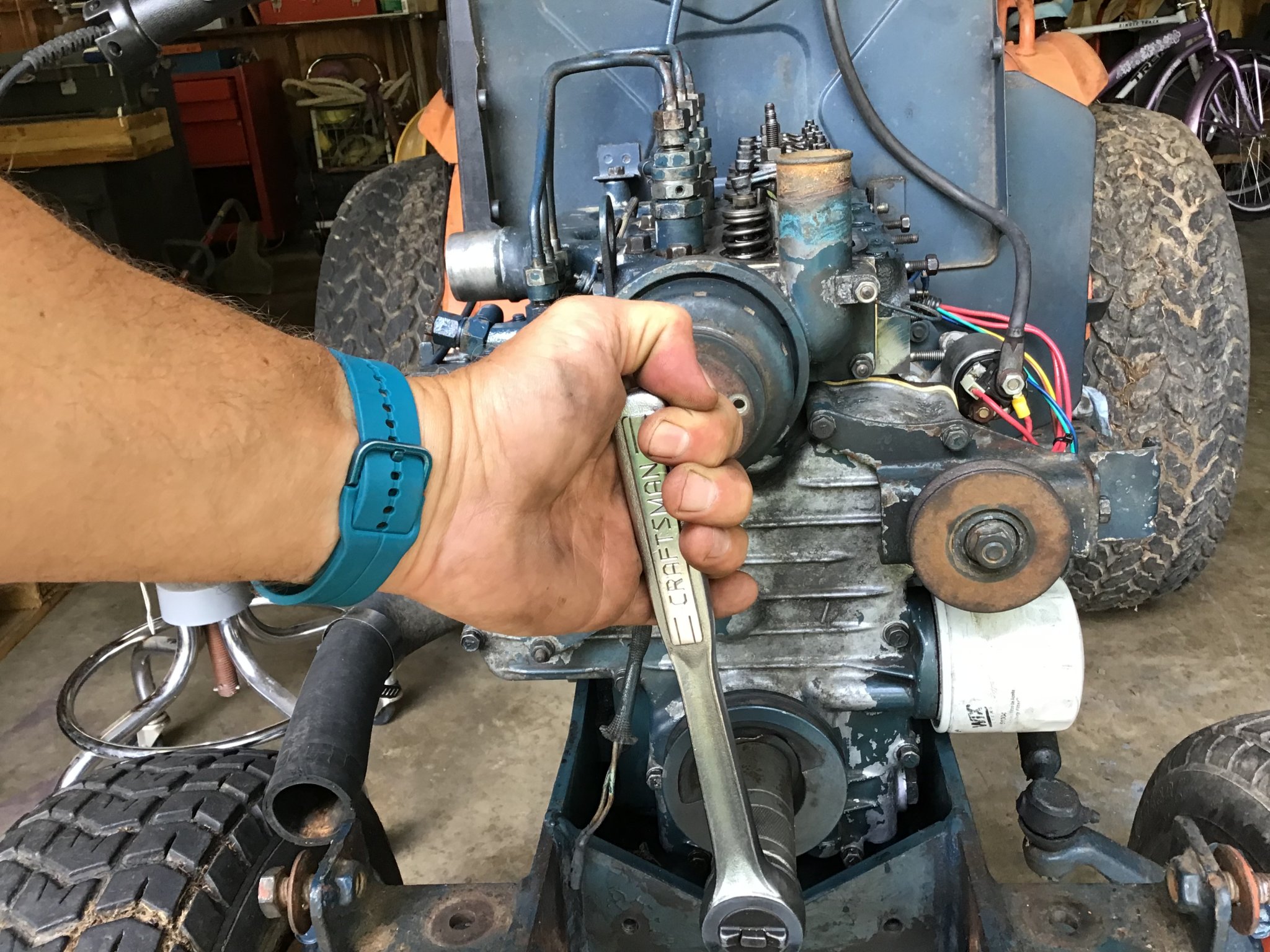

Woodman, I inspected and set the timing marks between injector pump, cam and crank and don’t suspect timing slip. However, it almost seems as though the intake and exhaust valves are opening in reverse order from what I would expect.
when I rotate the crank (counter clockwise, looking at the front of engine), the intake valve opens, closes and immediately followed by the exhaust open/close then a full revolution with no movement (power stroke cycle?).

It sounds right other than looking at the front of the engine it should be turning clockwise, counter clockwise if looking at the flywheel end. When you turn it with the starter, which way does it turn ? If it is turning backwards, that would explain a lot.

Interesting. Most engines turn opposite that. If you lower the 3pt all the way down, then move the lever to raise, then crank the engine and the 3pt starts to lift, then we know for sure the engine is turning in the correct rotation. Another way would be to connect a engine oil pressure gauge and see if it builds pressure while cranking.
