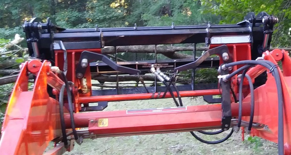

OK you guys know I have the LP grapple and I like it but as with anything there is always room for a mod.
So with that in mind, we know that gathering brush limbs ect. they sometimes push trough the openings in the grapple, getting very close to a very expencive radiator! So I was contemplating expanded metal maybe 1/2 inch opening, welded to the grapple closing these opening off on the top and bottom jaws and protecting the hoses and other things. I know I am not conveying my thought very clearly, but if you look at a grapple open and closed you will understand what I am thinking,,,, So input yea or nay and reasons.

I don't see why it would not work... I would think that a series of tack welds would hold it fine.
Also it's unlikely anything thicker than 16 or 14 gauge steel would be needed. If it's like my EA grapple it's only about 8-9" between the tines.

I think it's a worthwhile mod for your grapple. I have a Landpride SGC0660, which I happened to have used today for 3 hours moving dead Scot pines. One of the things that a grill guard would not help with but this mod would, is when branches poke thru and try and unlatch the SSQA levers, it has happened to me twice now, and yes I know there are mods to prevent this from happening.
The other thing that happens quite often is branches will poke thru, then get hung up when opening the jaws to place on a brush pile preventing the tree from falling free. Both of these issues are not a huge deal but I see no reason not to add expanded metal and make the operating experience that much more pleasant.

I suspect what you’re contemplating would help. But I don’t know if it’d keep all of it from poking through the upper/lower jaw “hinge points” (not really a hinge, since there just one on each end).

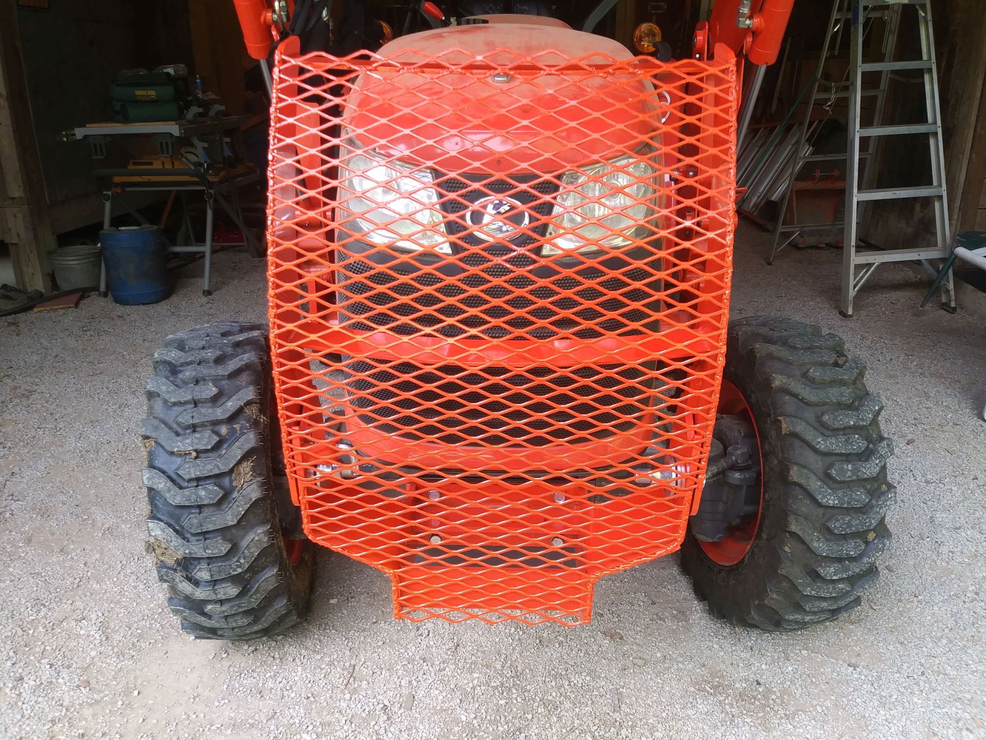

I’d say go with a grill guard. Your radiator/front end would be protected no matter what attachment you have on your loader. That’s what I did.
3,362
4,286
I’d say go with a grill guard. Your radiator/front end would be protected no matter what attachment you have on your loader. That’s what I did. View attachment 113326

Ever hear of a safety cable and a snap clip? Integrate one (or a lynch pin) to each SSQA Lever. Or run a rod from lever-to-lever with lynch pins.
