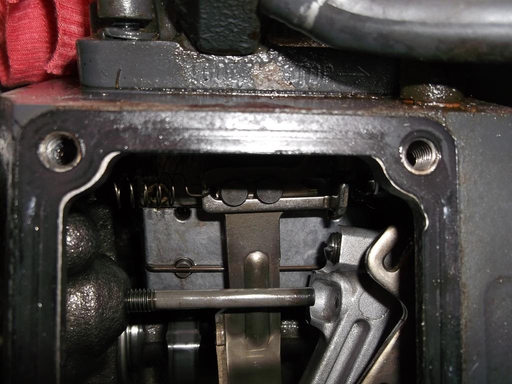

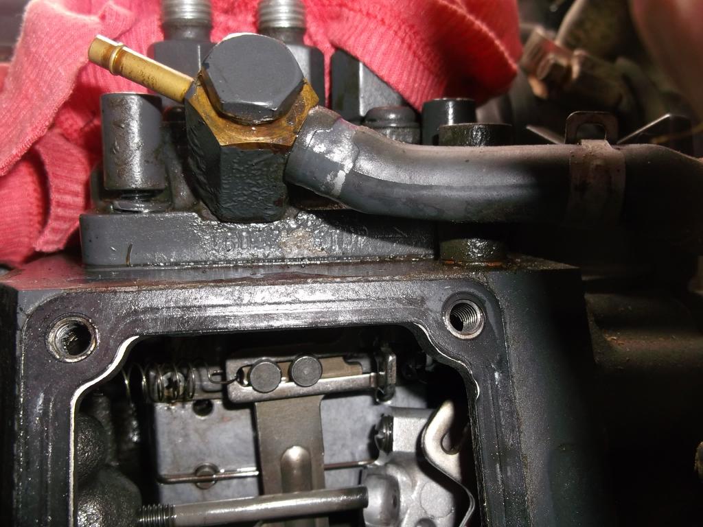

Moving the spring control lever while feeling in through the solenoid hole, nothing moves. I can see the return spring moving and feel tension, but nothing is moving. You can see from the solenoid opening photo that it appears someone has been in here before...

Weather finally cleared here to have another go...I removed the speed plate like you suggested. The forward most lever was seized (in the most rearward position, against the throttle lever boss). The slot where I believe the dog for this lever goes is actually forward of the upper right bolt hole, too far to the right and seems to be stuck there. It moves back and forth maybe 1/16". It looks like there is no way that the dog was even engaged in the U shaped cavity in the horizontal sliding "rack" (if that's the right term). The small spring on the rack that comes from the rear seems quite extended. Everything is free and lubed, but don't see how this can line up to re-install. Your help is appreciated,
Seann
One other question, I think Wolfman mentioned that it might be tricky getting the pump out if it is in fact stuck closed. I'm there...is there a trick you can share?
