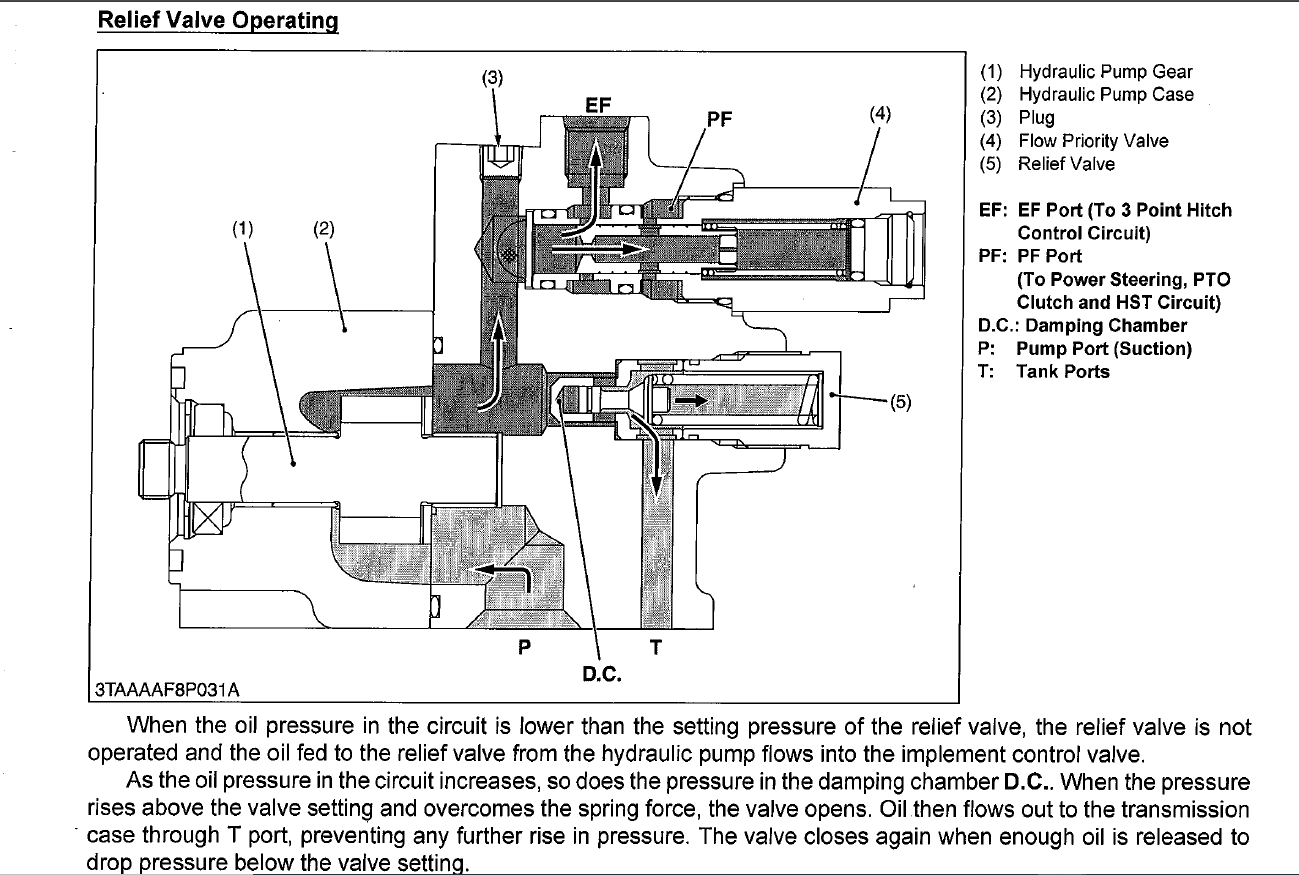

I was curious and downloaded the WSM. The relief valve you are adjusting is in the pump. Here is the parts diagram for it. Item number 90 is the poppet and item number 80 is the seat. The seat does not move - pressure is relieved when oil pressure in the damping chamber on the end of the seat forces the poppet out of the bore in the seat and oil flows past the poppet to tank. The spring is the biasing element that sets the poppet cracking pressure. I can see how over tightening the plug might make it difficult to get the seat out but I do not see how that will cause any change in poppet cracking pressure

If the poppet is not frozen and you have removed ALL of the shims pressure should be no more than factory specification. Flush that plug out good to make sure you don't have shims stuck inside it. The parts diagram also shows two plain washers inside the plug. Here is another cross section of the valve from the WSM.
