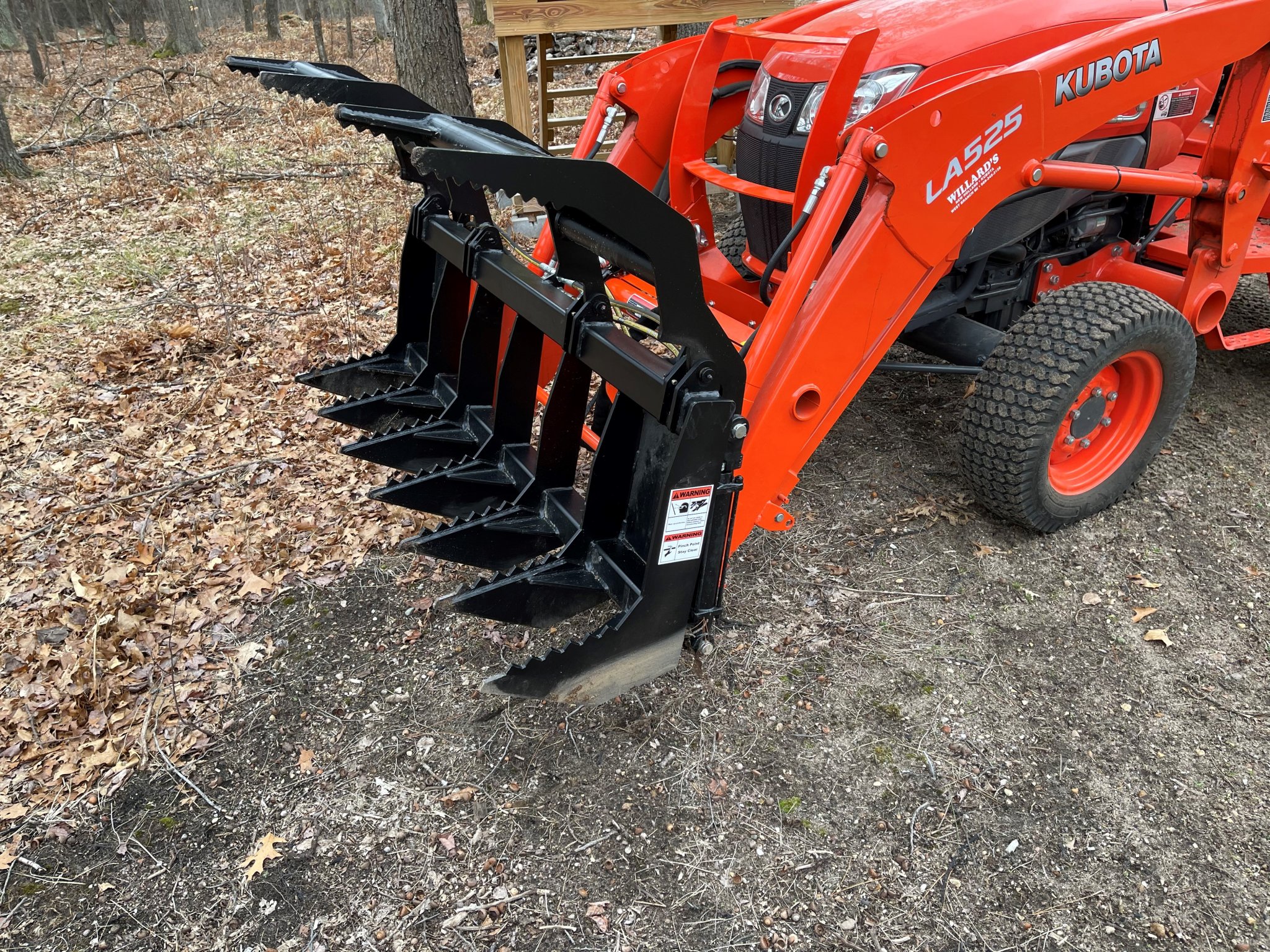

I was exactly where you are last year looking for a grapple for my L3901. Feel free to ask any questions. I posted some photos and comments in the link below about my final selection, an MTL CV twin lid grapple, I paid $995 including shipping when I ordered in December last year, they are currently $1,195 shipped, amazing value for a twin lid.
My MTL grapple has done a lot of work this summer, I’m still very happy with my purchase and consider it an excellent size and weight for the L3901.

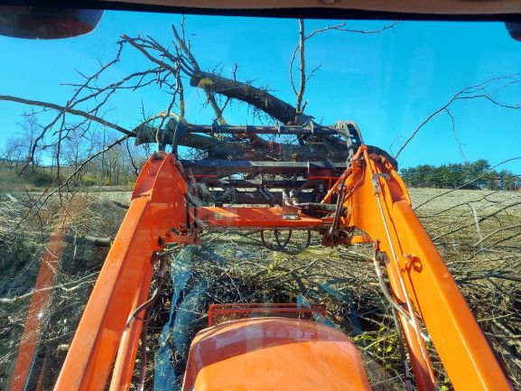

thanks for all the input. starting to leant toward the Wicked 55, but not sure about paying up front. lots to think about
I know I have been extremely happy with my 55" Wicked Grapple
