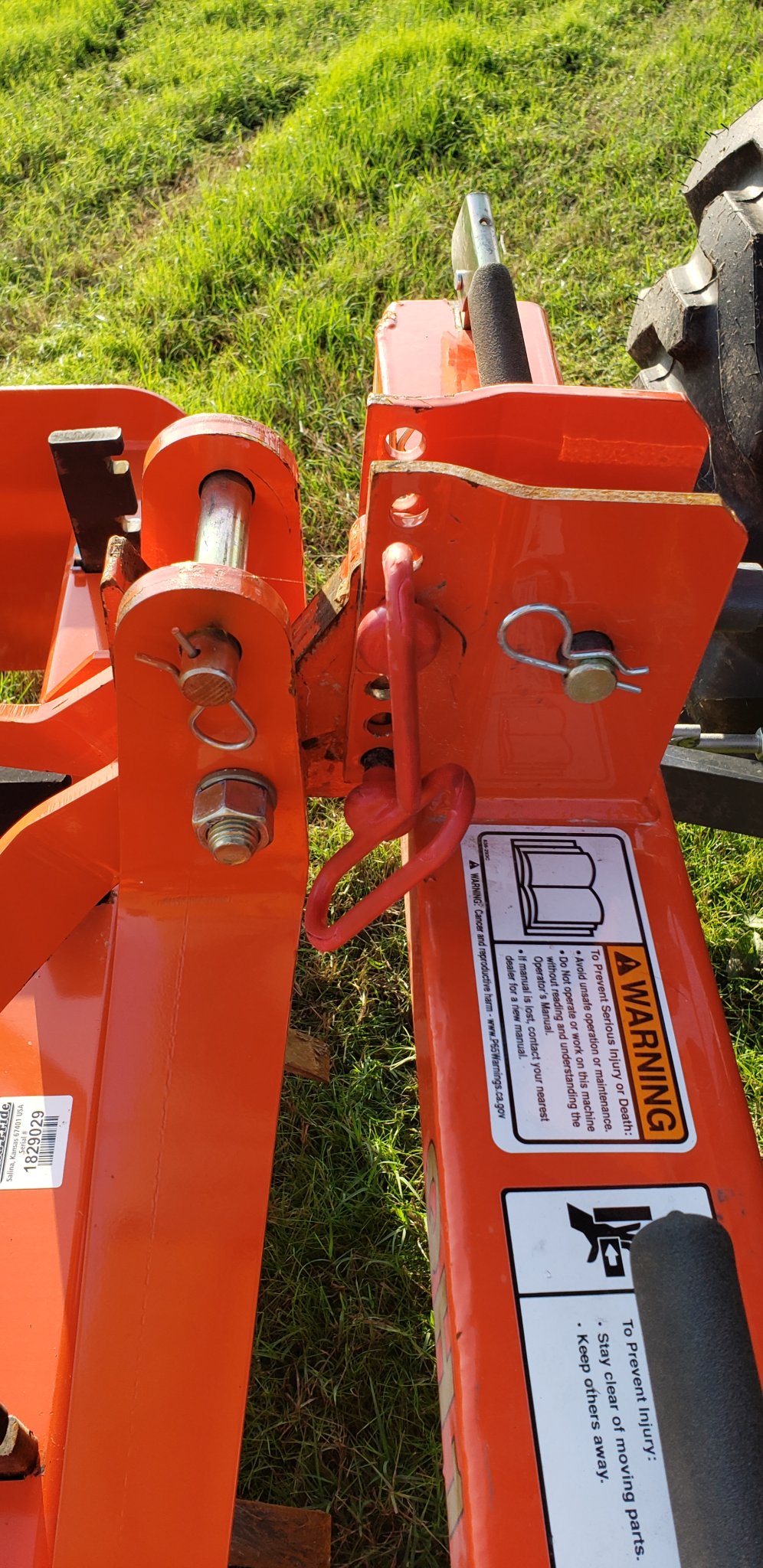

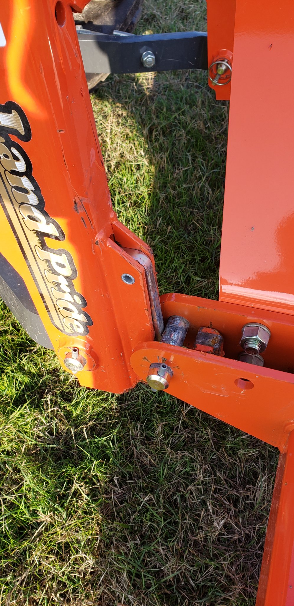

Im sure its something simple Im just missing out of frustration! I have a L3302 with a QH15. I always have an issue of somekind connecting implements. Yesterday I couldnt get the left side lower to connect no matter what adjustments I made! Top link great, right hooked up easy. Left is not going into the hook. Tried raising right side, lowering right side, kicking pushing cussing.... The left connector will not settle into the QH15 connector. Any ideas? Like I said Im sure its something simple that Im just missing.

If I was attaching implement to tractor after viewing your photos I'd move 3pt control lever rearward with engine operating at idle speed in order to raise 3 pt draft arms then unlatched side should latch. Then visually check to be sure it's latched.

Excellent pictures! It sure looks like the left side isn't low enough for 'engagement'. The two previous posts IMO should go a long way to completing the connection, however that's probably not the solution that will solve this issue.
The top link connection, IMO, is likely a major part of the problem here. I'm not sure if you've got the top link adjusted to a certain degree for implement 'angle correctness' but it could be a contributing factor affecting QH hookup.
The description offered by mcfarmall in a previous post seemed to clearly explain a proper QH engagement (at least it did for me) so I recommend reviewing that post & re-examining the QH setup, with respect to the above-mentioned top hitch suggestions. Good luck! :)
