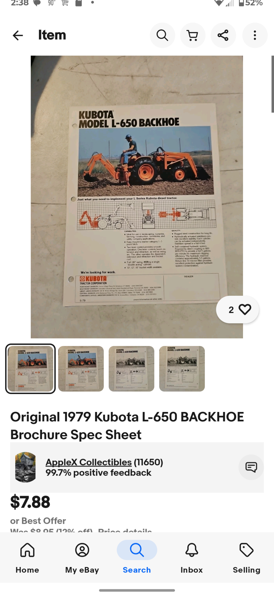

There's a spec sheet on eBay. It was designed for the L185 et al. Should be ok if you reinforce the top bracket on your tractor, use it carefully, and never let anybody else ever operate it.
Are you sure that it is for a L185? And how did you get the information? I have an L185F and would love to get a back hoe for it. Yes even a 3 point backhoe would be better than a shovel! The soil I have is clay and sandy clay so pretty easy to dig. There are few large rocks. So I “feel” that my use would be ”gentle” on the tractor.
I looked at the optional equipment for the L185 and didn’t see this L650 as an option. I don’t see a way to find what tractors the L650 was designed for so can’t figure this out.
If it is for an L185F, I might be willing to take a road trip from Texas to Utah to see it or start some negotiations with @Ktmud to send me information or pictures if he is not interested in it!
Google 'Kubota l650 backhoe specs'. For $8, you can have the brochure.

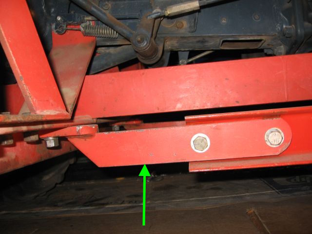

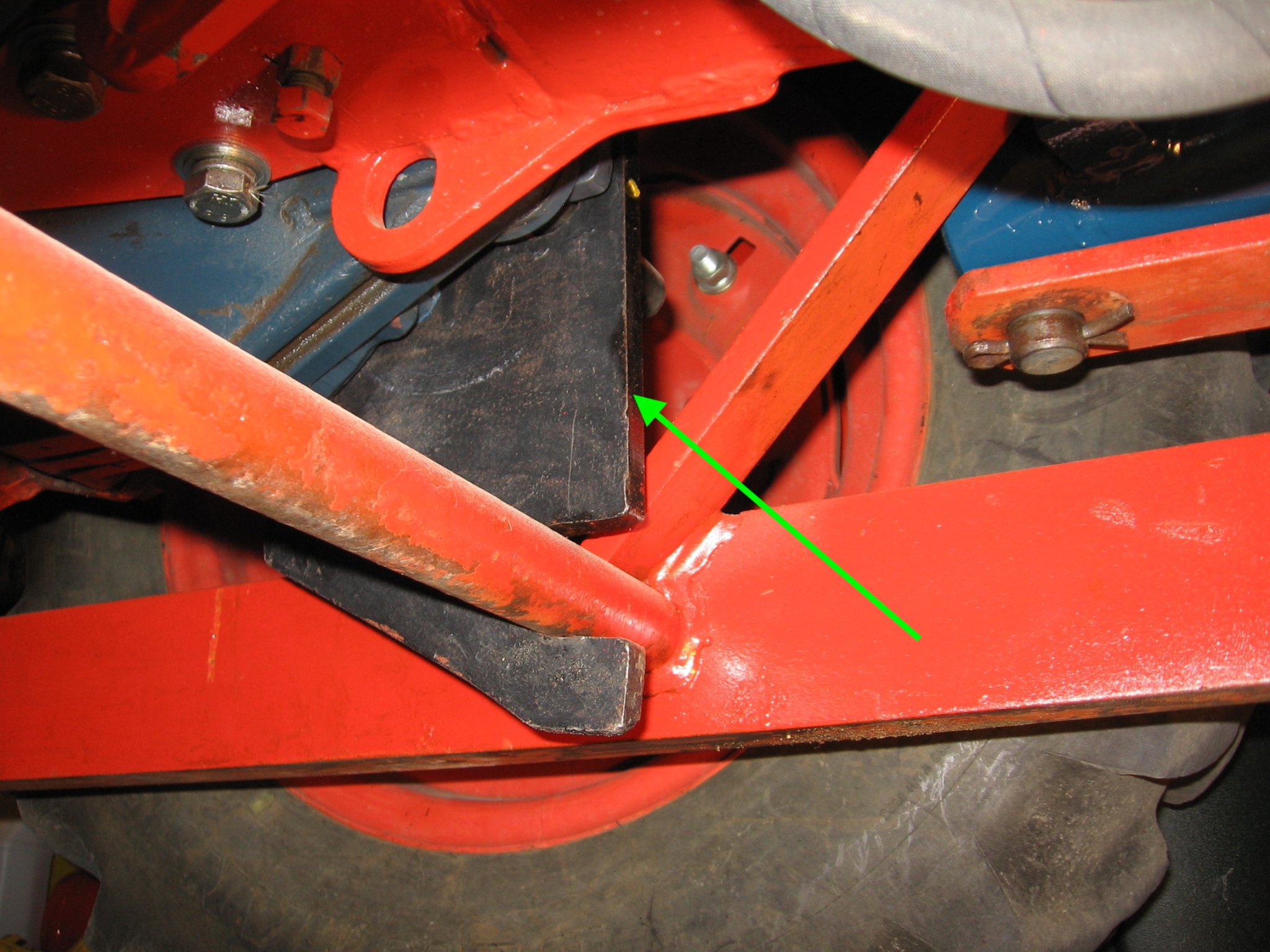

If I remember right, it needs the front & rear mounting plates/brackets, pictured below.
(I may have two of them, have to check)
(green arrows)
Other than those mounting plates, it was running when I stored it.
All functions worked, but with a lot of play.
