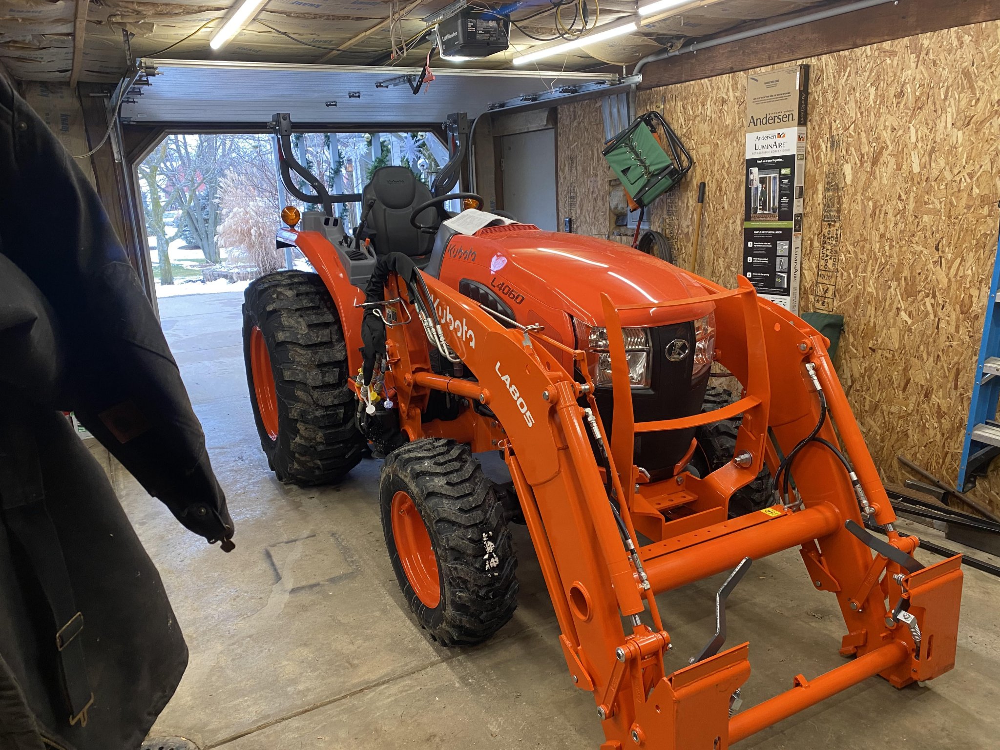

Well that didn't take long. Sheepfarmer turned me onto Aldermans a couple years ago. They went above and beyond when I was looking for a zero turn, and didn't disappoint this time either. They actually had to pull this tractor in from a dealer that is closer to me than they are, but I have never had a decent relationship with.
I ended up making a concession on the tires. I wanted R1, but they were unavailable within a reasonable time frame, so they cut me a deal on the R4. I'm going to groove them and if I am unsatisfied with that, Ill order some R14. Unless someone has direct experience going from R4 to R14 on this size tractor and can tell me to just get the R14 tires.
3 rear remotes and TnT kit should be here in a week or so and Ill install them.
I did get a chance to run it in the wood yard, It did what I expected it to despite having 0 counter weight but it does need some weight in the rear. I don't really want to load the tires so Ill either build or buy a weight box for the 3 point.
It JUST clears the garage door. Admittedly, it is larger than I envisioned.

Congratulations on your new toy. My FEL was a huge part of my decision. I am amazed how much I use it.

Without significant rear weight you will find the FEL just about useless.
I do not load tires either for multiple reasons so I have the maximum 3 cast iron weights on each rear wheel of my L6060. Still, without the weight box attached, it will not back up a slight incline on crushed rock unless in FWA. This with an empty (albeit somewhat heavy) 4-in-1 bucket.
It's a bit dangerous diving down my rather steep asphalt driveway with the FEL attached and nothing on the hitch because letting up on the hydro pedal just leaves a black mark.

I was able to do what I needed without any rear ballast, but I could tell the rear end was a bit light. This 4060 also has no issue lifting the rear trying to pick up a load where the 2650 struggled to accomplish the same thing.
Coming off heavy equipment after 20 years, Im no stranger to the need for rear ballast. I simply need to strike the line between enough, and too much. I just dissected the loader lift curves in the manual.... 1.6' forward of the pins, at approx. 2' off the ground is approx. 2314#. If I average a full cord of green, split firewood at 5000#, I should have no issues with face cords loaded in bulk bags. Of course there are exceptions based on species.....
